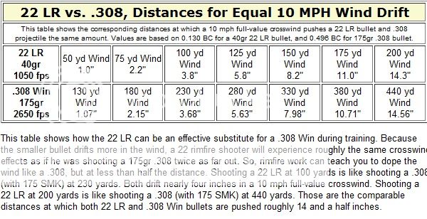

22lr to .308 haha quite the diff
Not at all. Shooting a 22LR out to 300 yards is roughly equivalent to .308 at over 600 yards. Everything you learn about drop and drift with the rimfire transfers over to the centerfire rather nicely.
Using a couple of common loads and a ballistic calculator gives the following results...
22LR 40gr high velocity with a 50 yard zero in a 10mph crosswind:
200yds drop of 40", drift 17"
300yds drop of 114", drift 33"
.308 180gr Nosler with a 100 yard zero in a 10mph crosswind:
425yds drop of 41", drift 15"
625yds drop of 116", drift 36"
So you can see the numbers are very similar at double the range for the 308. Not so "diff" after all.
Actually....
http://www.6mmbr.com/rimfiretactical.html
