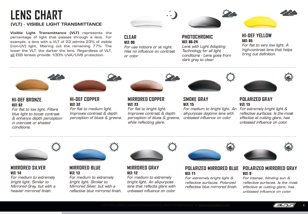

Can someone explain under what conditions the smoke gray and hi-def copper lenses would be optimal? I'm assuming from alpining's suggestion that the clear will work best for me when shooting from a covered bench.
EXCELLENT choice!
In answer to your question, see ESS' lens chart below
