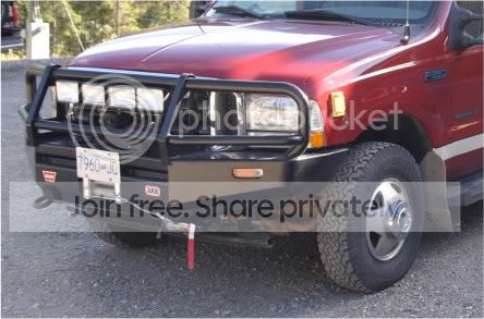

With a heftier ARB accessory bumper and a Warn 12K winch we burned the ball joints on our diesel F350 by 65,000 Km's, although the diesels are harder than hell on suspension as is. Rebuilt with Spicer parts and we'll see how it fares this time around.
As for your bumper, you will find with that style the lower skid bar is going to be very visible, and a little ugly. It is important though, so unless you plan to replace it with a front skid plate, I would take the time to paint it while the bumper is off, so at least it is not so obnoxious. Ours was very clean when we mounted the bumper, so it matches and hides reasonably well under that monster.

Here's the winch with skid plate installed. It protects the radiator and tranny cooler (okay).
Side view.
I've still got stuff left to finish this job. The Ford has two driving lights, that mount in the stock bumper. They are disconnected and remain in it. I've got to find an after-market light, that uses the Ford wiring connectors, then mount them on the new bumper.
We did a fair bit of driving the last couple of days, looking around for bear. I have to say, I have noticed a bit of a different feel in the front end-suspension, due to the added 250lbs weight of the winch & bumper.
