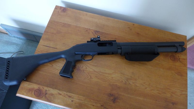

I know it is a bit of a necro post but is there a reason why you have the brake installed upside down? That would explain the burning on the mag extension. I'm guessing one needs to use crush washers to install the breacher brake?
No it actually just threads onto the end of a choke (which threads into the barrel like any other choke)
