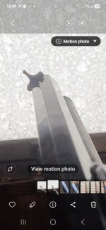

I did like you suggested and looked in the sunlight, and saw a faint bulge. I put a 3x9 scope on it, and with 140 gr .357 loads I shot it at 50 yds today. I don't think it affected the accuracy. Here's a few pics.

Isn't it amazing how you can instantly see a bend in the glare where an almost indiscernible bulge is. I was shown that tip by Ron Smith almost 40 yrs ago now.
Google "Foucault knife-edge test"
It's how people who grind their own telescope mirrors test for accuracy down to a fraction the wavelength of light. Like down to .01 thou or .00001" just by using light and looking the right way with a razor's edge.
