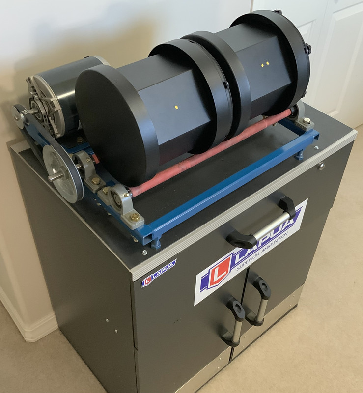

This is my home brew wet tumbling brass cleaning set up. I found a single drum capable of 15# of brass was not enough for my needs. When shooting in multi day matches, I found that I needed to clean a lot of cases. And sometimes, different calibers could not be tumbled together because of getting smaller cases stuck inside larger ones. (Think .357mag getting stuck in a 45-70 case.) Thus up scaling to a dual drum set up. Now, I can max out to 30# of brass if needs be. And I have done two drums a lot.
The motor is a 1/4hp wired for 120v. The bearings all have greasable points. The only “wearable” item is the red heater hose used on the roller shafts. Easily changed out when it gets too worn. Although after many years of service, I have yet to have to change it.
