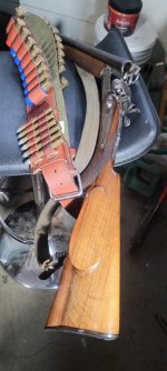

I shoot a variety of black powder loads in
2 1/2" brass cases, most however are around 80 grains of FFG and 1 ounce of nickle or copper plated shot.
I use unused wads .
I also have a low pressure Smokeless load
For 2 3/4" Federal shells and 700X that develops 5700 PSI according to Hodgdon.
