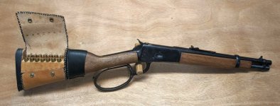

- Chiappa M92 “Alaskan” in .44 mag (12 inch)

At that time I also tried a 1906 mfg Winchester M92 in .44 mag and M92 clones in .357. The Rossi is an excellent "starter" rifle for Cowboy Action shooting, my wife used both the Browning & Rossi for 3 years before upgrading. Unfortunately as you get more experienced (read as faster) running a M92 clone lever gun, things like stovepipes start to happen. The Rossi will not run smoothly with semi wad cutter ammunition, which is consistent with most Winchester M92 clones. Surprisingly my Chiappa M92 Alaskan in .44 mag runs semi wad cutters perfectly. I love my Chiappa as a bang around rifle, but M92 clones are not meant to be competition rifles. The main problem that I have with M92 Clones is the more experienced you get running the action (read as faster), the better your chances in having a "Stovepipe" are, and these can be a royal pain to clear.
I bought my Chiappa M92 "Alaskan" w/ a 12" barrel 5 years ago as a fun gun. During the first year I tried over 30 different reloads, and developed a nice reload for 25 yd indoor shooting, a great load that gives me a 3rd 2" group at 50 yds and rings an 8" gong at 100 yds and a nice 300 grain hard cast Bear defence load that moves down range at 1,320fps. This is the only M92 clone that I have run that will flawlessly cycle lead semi wad cutter bullets. Because the larger “D” ring lever which takes longer in time to complete a cycle I have never had a stovepipe with it.
I understand that some early Chiappa firearms were problem children, like their copy of the M1 Carbine. The apparently they responded to the bad reviews. The fit and finish on my Alaskan is extremely good, it has never jammed, especially with lead semi wad cutter bullets that still leaves me gobsmacked, I have never had a jam as I do NOT try to run it as a race gun for competition. The Alaskan is a good solid, well built lever action carbine and well worth the $1,600 that I paid for it in February 2020.
