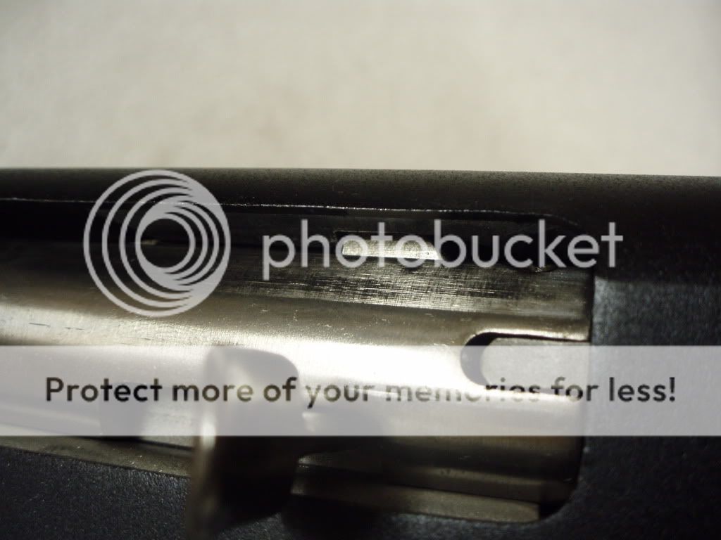

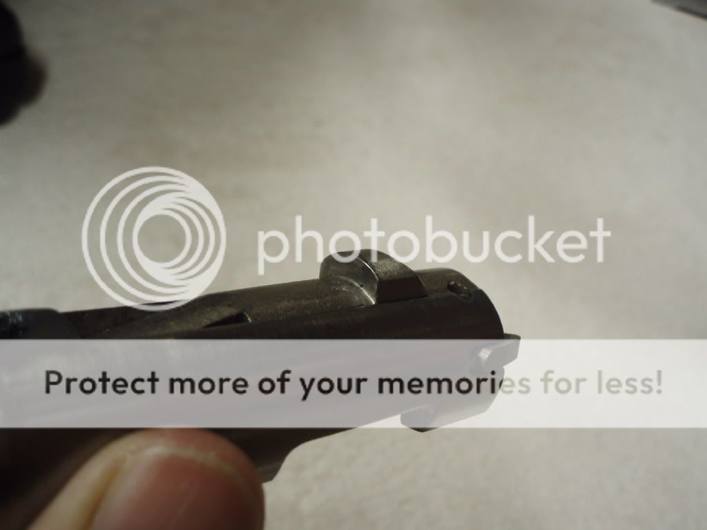

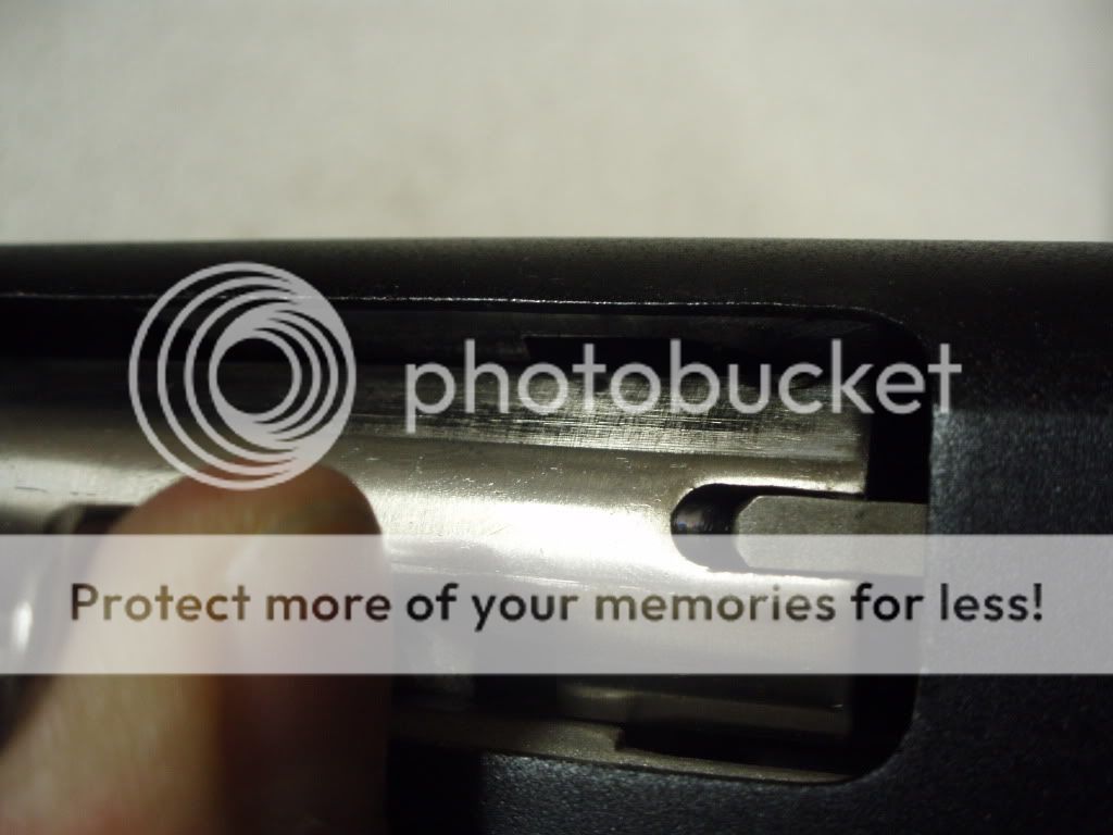

You should see the relation between the lock lug on the bolt and where it make contact with the barrel in these pics:
Bolt Closed lug extended and lock the bolt in place:
Bolt Opened lug recessed and unlock the action:

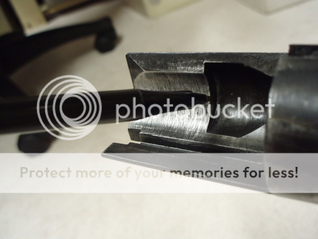

This is the recessed area on the barrel where the lug from the bolt make contact with
You can feel the edge if there is any rough edges which you will be smooth it out by using 600 grits wet sand paper wrap around a pencil or rod easier for you to take the rough edges off (where the tip of the pen is).
Most likely you will be safe as long as you are doing this hand and it shouldn't takes you no more than 5 mins.
Next check the lug lock on the bolt
You can do the same thing to the very edge of the lock lug but remember use your hand to take the rough edges off only and "DO NOT" reduce the size or thin the surface area of the lug (chances is unlikely if you do this by hand but just a reminder).
After smoothing out rough edges on both part clean as usual and assemble the gun and do the slow bolt release test again and you should see some difference there.
Try it out and let me know if it works for you.
Thank you, great pictures & explanation! I did notice some wear on the locking block & polished it with 1500 grit with Ballistol - I know that doesn't remove much, but I wanted to be on the safe side. But I didn't notice the wear on the barrel, thanks for pointing this out. I'll try & report. ;)
