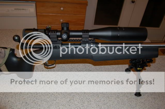

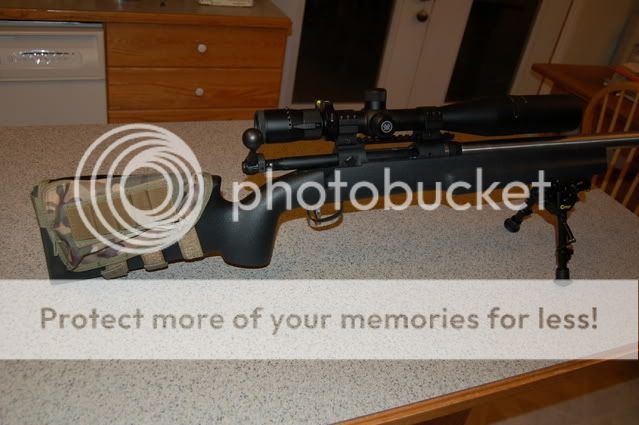

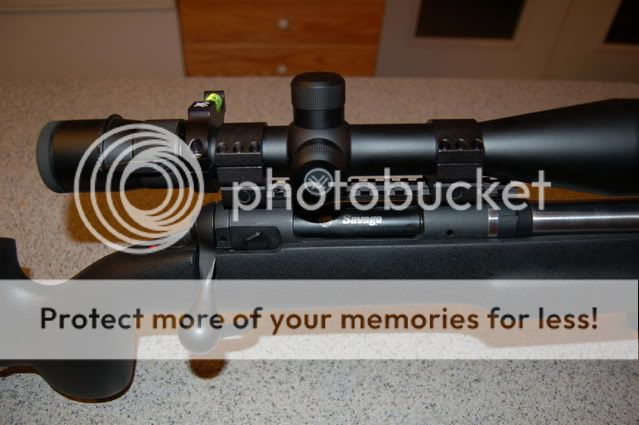

Well it has been a long time coming, but I finally got my own LR rifle. I am going to use this rifle just for informal shooting and to learn how to shoot well beyond 300 yards. Here it is...
Savage action with Accutrigger
Shilen Select match barrel, chambered in 260 Remington, 1 in 8" twist
Bell and Carlson Gold Medalist stock
Precision ground recoil lug
20 MOA Rail
Caldwell swivel bi-pod
Vortex Viper 6.5-20X50 BDC scope for now, but I am waiting for rings so I can mount my Vortex Razor 5-20X50

Okay! Okay! Here are some pictures!

Okay guys, I am not the handiest fellow on the planet but I finally figured out how to post a pic, so here is one for all you guys. Like I said, the rifle is currently wearing a Vortex Viper 6.5-20X50 BDC, but I am waiting for my 35mm rings to mount the Razor that is also in the picture. I also threw in my Vortex Razor HD spotter and my Vortex Viper 8.5X50 binos. I hope you enjoy!
