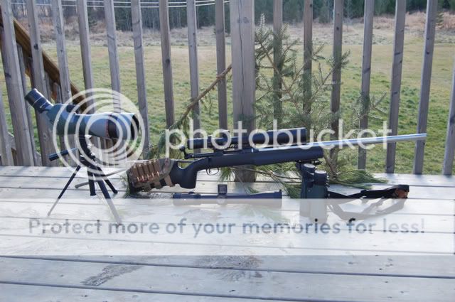

Okay guys, I am not the handiest fellow on the planet but I finally figured out how to post a pic, so here is one for all you guys. Like I said, the rifle is currently wearing a Vortex Viper 6.5-20X50 BDC, but I am waiting for my 35mm rings to mount the Razor that is also in the picture. I also threw in my Vortex Razor HD spotter and my Vortex Viper 8.5X50 binos. I hope you enjoy!

Now for some close ups.

I will edit my original post with some close ups of the rifle and equipment.
