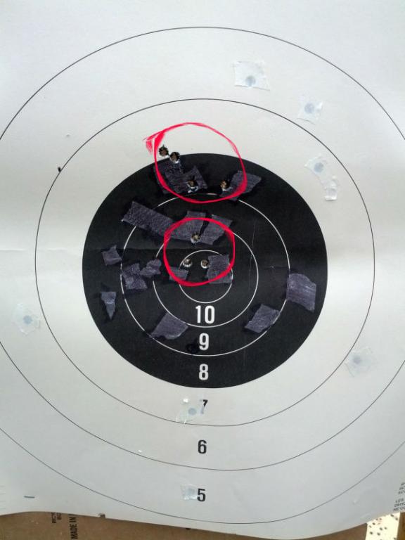

Well I finally got out to do some serious shooting. Ammo was standard 1969 LC ball. This was (stupidly) the only target I photographed, but it's illustrative. It was my second target of the day. The top group is horizontally strung as I made a slight windage adjustment to get me closer to the bull and the bottom 3-shot group was shot slowly, prone with a sling, after correcting for the elevation being out in the top group. Group measured 0.8" across. Not bad for 100m with a military 4-groove barrel.
I'm happy with how this build worked out :)
PS: Yes, I'm a cheap SOB and re-use patched targets for practise... lol.
