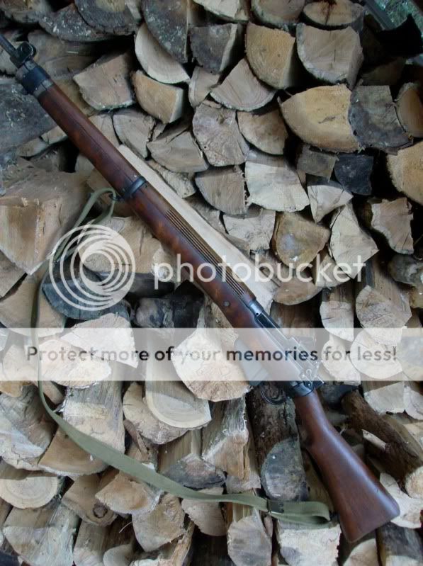

Well I haven't refurbed a No4 in a while, so I thought it'd be just about time.
The barrel, receiver and bolt are number-matching - but that's after an "FTR" at Fazakerley (unfortunately not dated on the receiver). Got them as a sporterized rifle with no magazine. Good shape 5-groove barrel.
The forend for this one, I got about a year ago from Trade Ex. Yes it has the "Ishy" screw... oh well I don't see it as a sore spot. It does have nice waves of different shades in the middle, which is neat. Bedding was not too challenging. Besides removing a few minor contact spots between the barrel and the forend, I had to slightly shim at the rear, under the rearmost part of the receiver, to get the right upward pressure at the muzzle.
I didn't do the best job possible on matching the color of the rear handguard with the other parts, I'm not satisfied with this; I will do better next time!
Wood was finished with BLO.
Can't wait to see how it shoots...
Lou
