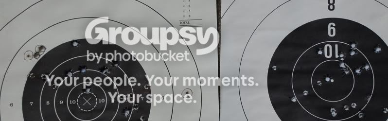

I've fire lapped quite a few rifles and did another this morning. It was a C. Sharps 1875 model in .32/40, with plain base bullets.
I fired ten rounds of a carefully assembled load, then twenty-nine lapping loads with cleaning after every few shots. I then cleaned the bore again and fired ten rounds on another target. The photo shows the results. Please discount the .22 holes in the target.
The first target had a flyer and so I just measured the best nine out of ten on each target, The CTC group on the first target was 3.34 inches and the second target was 2.41 inches. That's about the best that can be expected from six decade old eyes and just a single front rest. The targets were at one hundred yards, so now I think that I'm ready for two hundred.
