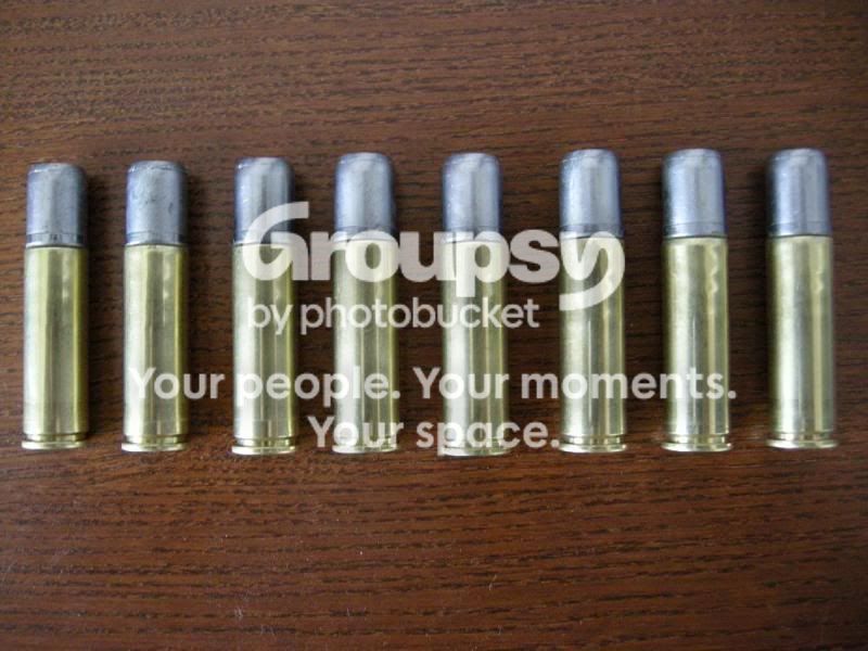

Here they are - its completely different feeling to load your own bullets as opposed to bought ones.
700gr 500 S&W - the bullets are not perfect but they are usable :)
(My seater seems to leave the mark on top) I did try to flare the brass a bit more to make seating easier.

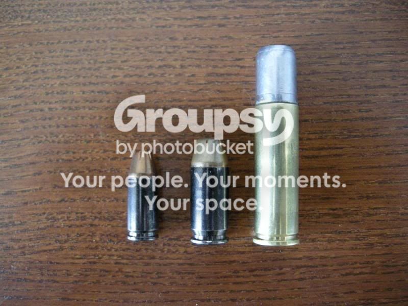

9mm / .45 ACP / .500 S&W

Paulinski: if you can remove seater and spin in a drill, drill press or lathe, polish that edge with medium then fine emery cloth. Works well on seaters and expanders.
You can also form the seater using 2 part epoxy. Coat the bullet in some sort of release agent like a light coat of wax or case lube. Mix up some epoxy then apply to the seating punch and put the two square to one another by whatever means available. I used to run the seating plug down as far as it would go, then moosh the bullet affixed to the case against it all mounted in the press. If it sounds complex, then it's because I'm bad at explaining stuff. Or you could just live with it. The difference is only cosmetic in my experience.

Factory rounds cost $2.50 and the heaviest bullet I was able to to find is 400gr.
As to why - I dunno I guess because I can and the satisfaction of creating such monsters by myself.

Is that reload not too long for the cyl? I'm making a LBT 500 gr. LFN Gc for the .500 but haven't had any feedback yet on it's accuracy or smackdown.....congrats on the 700 grainer!!!
Max OAL with 700gr is 2.320".
