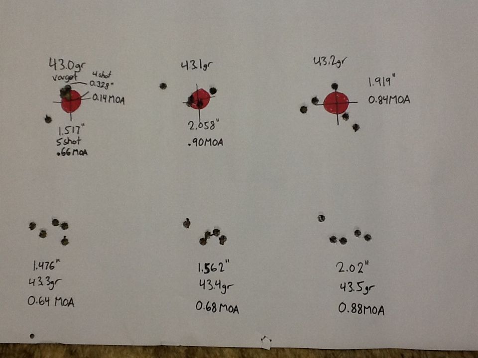

Mine MS is similar in vertical mvmt and little effect in group size outside of shooter competence. With that I now do accuracy test with MS starting with .5 steps. Find the group size tends to trend with ES/SD. Then move to .1 around best ES/SD.
Makes senses as trajectory is function of muzzle velocity/BC.
Mine shoots about 1" high at 100 yds with the Magnetospeed attached. It does not affect group size much but I always do accuracy testing first, then once I'm happy I attach the magnetospeed and fire 10 to see what the velocity of that load is.
