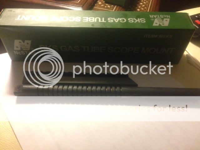

I got back home and put the stock gas tube back on and I am pretty sure that I figured out what the problem was.
it was the crappy made in China NcStar Gas Tube. The piston was a bit loose in the NcStar, and nice and tight in the stock one. I could feel a bit of suction being created with the stock tube and piston, and in the NcStar tube the piston rattled around just a smidge. Plus the stock tube mounted more snugly and the chinese one was maybe 1/4mm looser.
I'll be heading off to a range as soon as I can to test the theory, but I am pretty sure this will solve it.
here is the pic of the NcStar tube and box.
