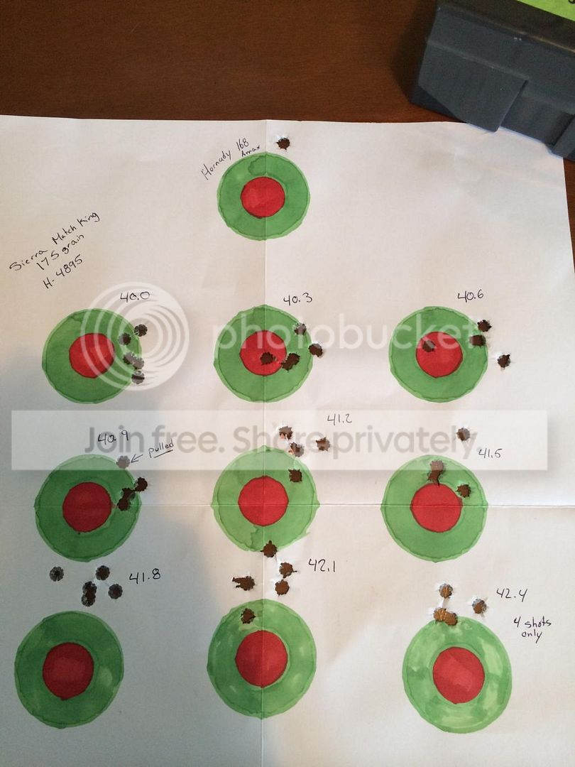

Here are my results for my first hand loads ever!, I'm really happy with the results, they are all 5 shot groups except for the first one (3x hornady that i used to heat up the barrel) and the last group. i think ill stay with 40.9 gr since it gave me the best results of all, with 4 bullets in 3 holes and the other i pulled the shot, i knew i had pulled since i pulled the trigger and didn't let it slide like i usually do.
Rifle: Rem 700 AAC-SD, Twist 1:10, Sierra 175 MatchKing, H-4895, Brass: Norma, Primer: Federal 210, COAL: 2.820
Testing at 100 yards
Let me know what you think of the groups!
