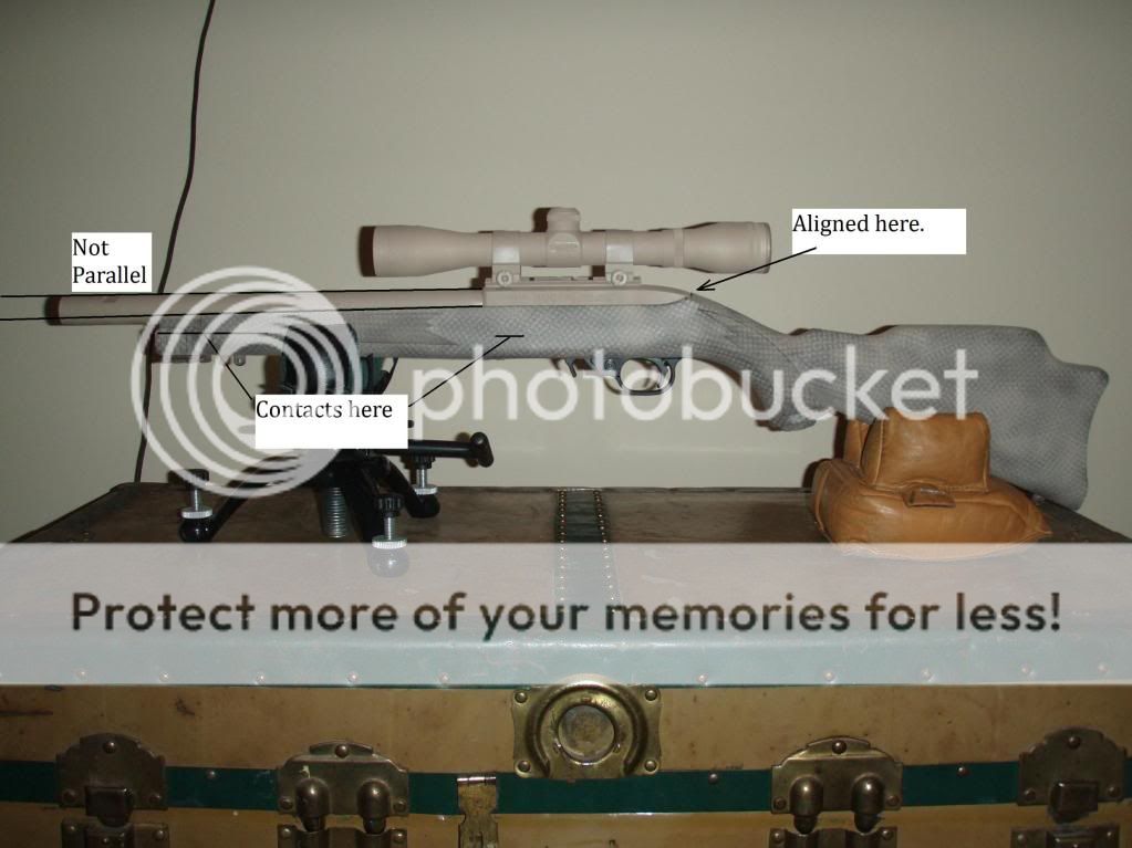

I consider this 10-22 build entirely your forum's fault;) Which leads to my question.
Did I channel the stock correctly for the barrel? Hoping Surfclod reads this, love your build, but I didn't see any straight profile pics of your rifle (and I find the search on this site easy to use). My 11/16 socket says my groove is true (Who knew they could talk? Let alone have an ear for music) but it sure looks like the barrel is rising out of the stock? It floats, with a rubber rest on the second rib from the front, the action seems straight, but why not ask the experts?

When I removed material from the forestock for the heavy barrel I kinda just eyeballed it. I cut out the ribs in the forestock and have an aluminum flatbar running in there to stiffen the flimsy stock and attach the picatinny mount. The last 4-6 inches of barrel is bedded with Bondo, I Kiwi waxed the barrel (as a release agent), put in the Bondo and clamped it together. Once it hardened I have two contact points, action screw area and last 4-6 inches of barrel, so its not free floating but I am not concerned with that.
Looking at it again I notice that like your build, my barrel and stock do not run parallel, but rear of the action aligns with the stock which is more important in my mind.

:eek:Wow, Thank you for the prompt and detailed response! I was actually going to build an AR 10-22 until I saw yours:cool: and unashamedly norincoed your idea:redface: I'll probably keep following your footsteps and bondo bed it, seems like I'm roughly at those contact points already... have fun with the build my credit card company loves mine! C'mon G36!
