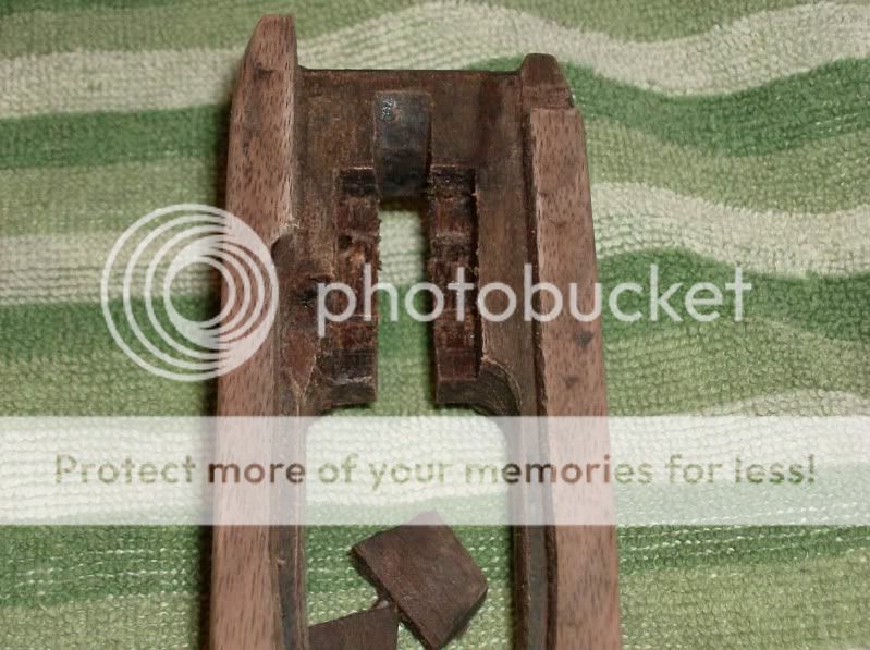

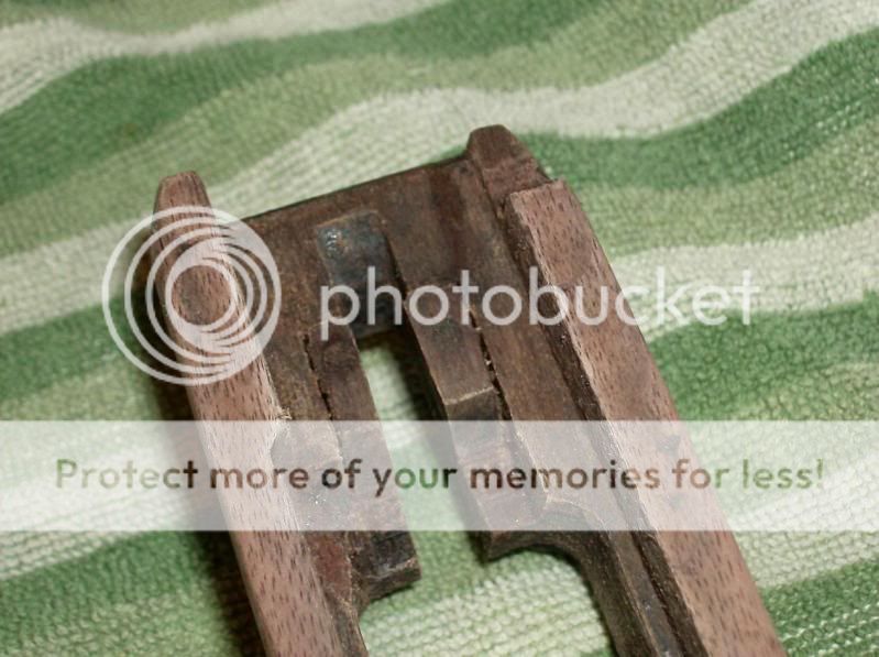

Here are pics of the first thing I'm working on: the recoil lugs (or "draws"? "faces"?)
The damaged, loose, too-short previous repair:

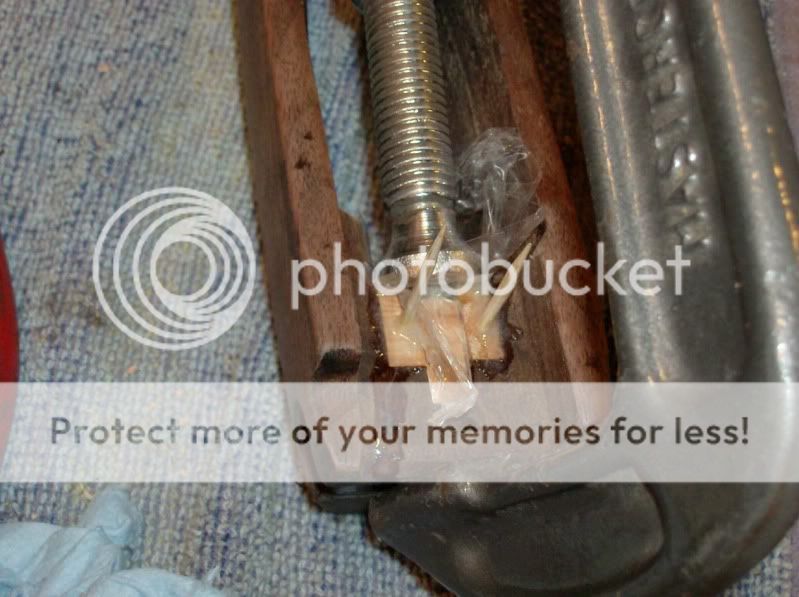

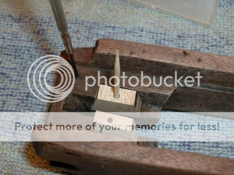

I carved replacement wood blocks, slightly larger than the ones I removed:
Now I'm waiting all day for the epoxy to harden before resuming the work.

With the forend pictured above, after the glue had cured, it took me about one hour to remove just the right amount of wood from the two sides for the right amount of pressure. Bit by bit, slowly... I was done just before dinner.
