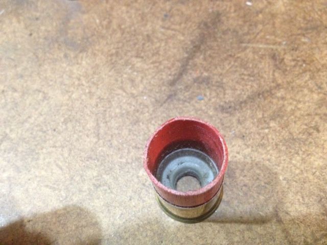

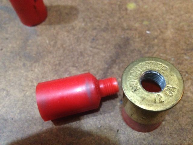

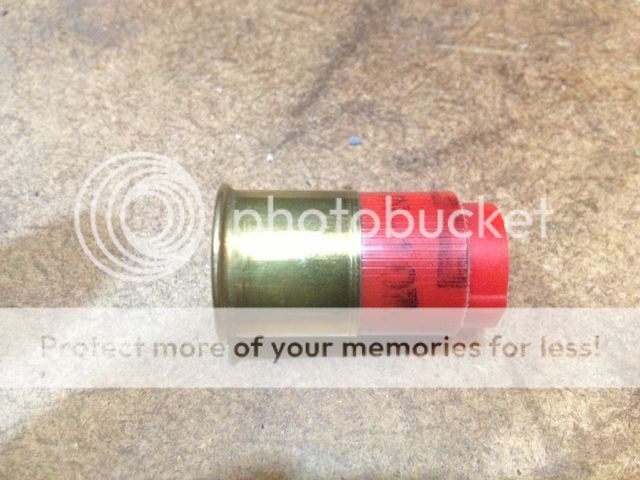

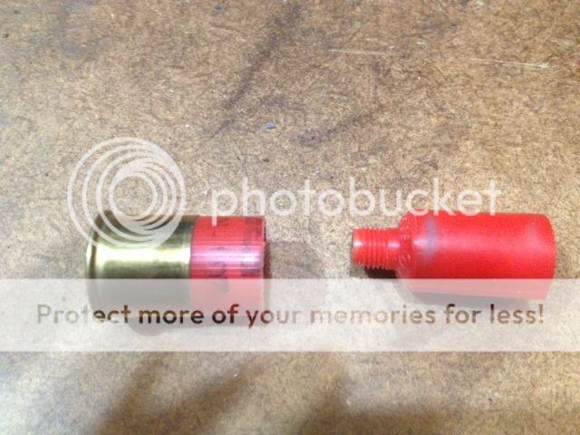

Actually easier then I thought. There is the perfect amount of meat at the base of the 12G shell. In fact when the flare is threaded in it seats itself flush with the bottom of the brass.

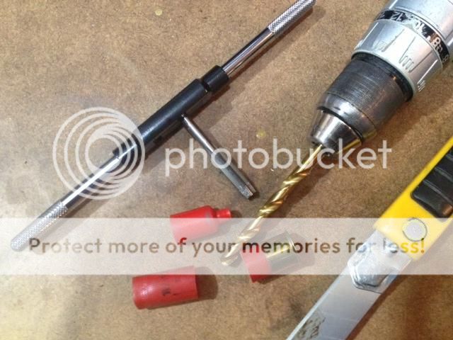

Drilled a 21/64 hole and tapped it with a 3/8" 24NF tap...... trimmed back the plastic hull and voila.

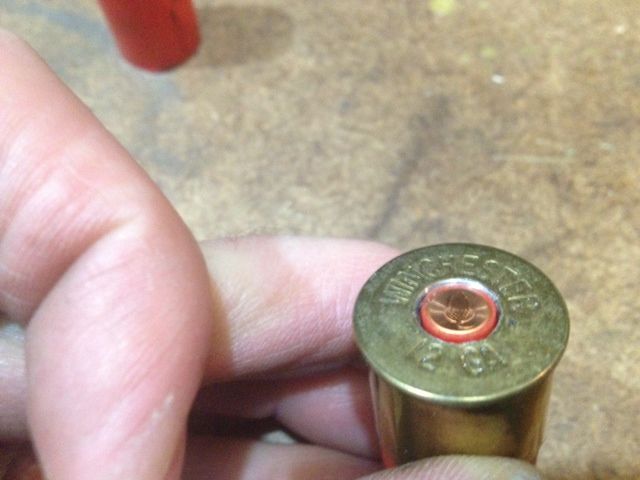

All that remains is to see if the hit from a 12 gauge firing pin will be enough to ignite it.....the pin on the flare guns is pretty big.
The pen flares are rim fire, the 12G ones center fire.

Well I took one out and tried it......wouldn't ignite.
The firing pin on the center fire pen launcher is quite a bit bigger then a typical 12G firing pin. I've had the bangers for a long time so it's possible they were compromised.
I left the banger at the test site as I wasn't keen on driving off with it only to find out it was a slow ignition! The hit to the primer area was fairly substantial but not enough.
