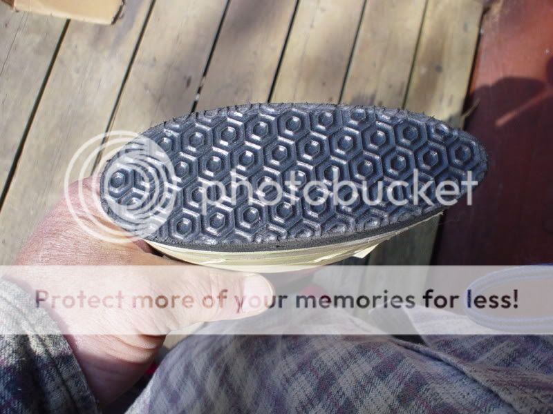

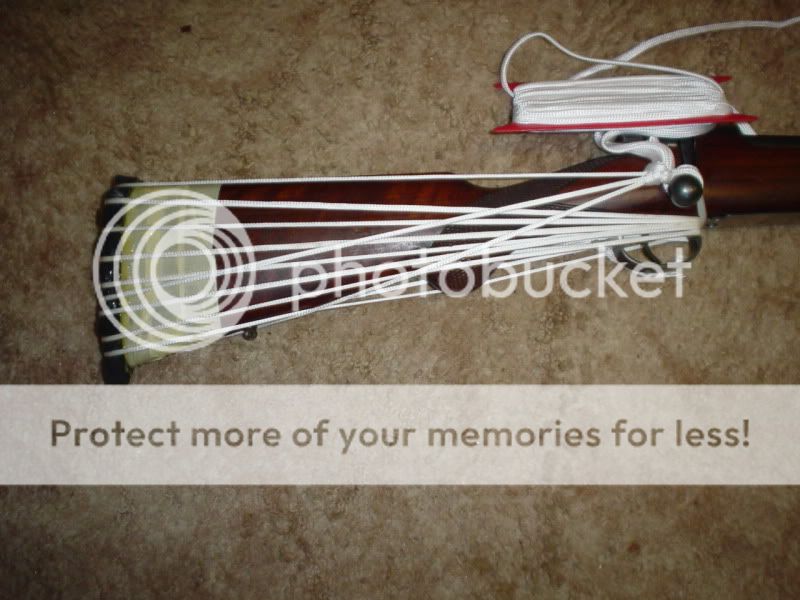

Thanks, that is my best one so far! And for maybe $7 including glue and tape it’s hard to beat!
So I went and bought a pair of size 12 black flip flop for $5.25 all in, prep them so I could glue them face to face to make a nice thick pad! Ground off the “threads” on one of them to glue onto the stock. I have enough for an other pad!
Anyway here is some pictures of my process! It is going on a 303 improved made on a Globe no1 mkIII!

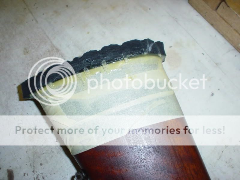

I finally did one - some pictures below - might need more than one posting for all of them - I put some words BELOW the picture. The rifle was a push feed Winchester Model 70 that was received without a butt plate or recoil pad - rear face of the stock was more or less dead flat - I used some 100 grit sandpaper on a 2x4 block to "freshen it up" a bit before I applied the contact cement.
I set up the stock about as "red neck" as I could come up with - the barrel's muzzle is on a couple 2x4 blocks on concrete floor - then I used a pair of "squeeze clamps - one set to grab onto the stock, and other set to anchor tail of first clamp to the "sit down when working" work bench.
Image shows really roughly chopped out chunk of flip-flop and the butt soaking with contact cement partially dried - I let that go until neither would stick to clean paper set on them - then stuck them together.
Contrary to earlier posts - I could not find water based contact cement in our small town stores - so I ended up to use "LePage" brand Contact Cement - "Heavy Duty", which I found at local Home Hardware store. Most definitely a solvent based stuff - good fumes coming off it when that can was opened. I can not smell anything at all now that it is all dried and finished.

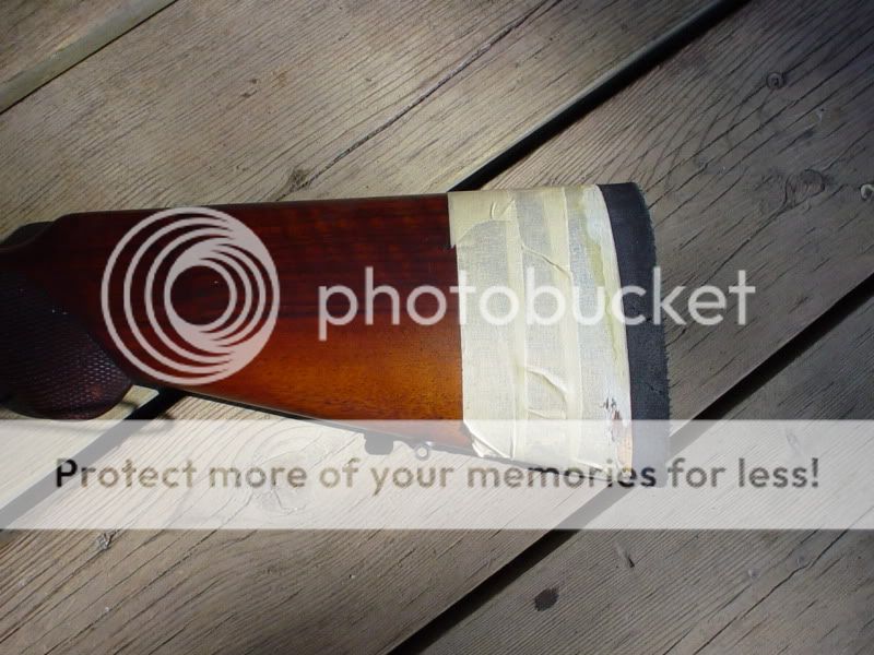

By the way - that is "three" layers of masking tape - a 1/2" wide light green layer, a 1.5" off-white layer and a 2" wide dark green layer. Was a royal PITA to get the edges to match up with the wood edge of the butt - so I had left some a bit proud and cleaned it off with the sandpaper on the wood block.
That is the irregular shaped thing stuck onto the wood - just pressed down really snug - used a 1/2" dowel end to get every square centimetre squeezed together - was LOTS of excess to be trimmed off.

I used that belt to get so that it would scuff that first layer of masking tape - to expose the second layer - or at least that was my plan...
That plan seemed to be working so I got "brave" and removed the two outer layers of masking tape - down to that last 1/2" wide layer - and managed to scuff through it to hit the wood, which I was hoping not to do. I must be getting old or weaker or something ...
You should be able to see the white marks where I managed to scuff that wood - did not really want to completely refinish that stock, so thought I would try to "touch that up".
I used an artist small paint brush and sloshed on a line of some MinWax brand "Gunstock" stain - #231 - seemed to have quite a bit of red in it - I intended to rub that off, but forgot about it - so what you see is just that stain sloshed on full strength - likely should have a varnish or something as a filler to match up to the shiny factory finish on the stock, but what you see will have to be "good enough" for what I intend for this rifle.
