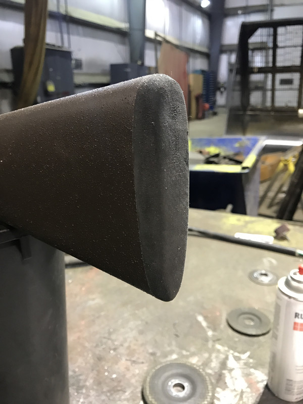

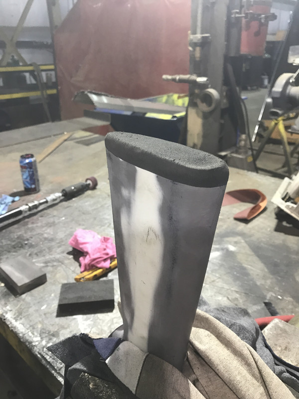

DGY does his first Flip Flop recoil pad!
DGY does his first Flip Flop recoil pad.
An orange one at that!
His first comment was, “Looks like a Rigby.” ;)
Ted

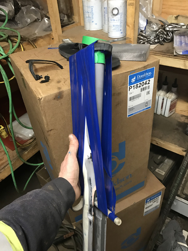

Ted do you still use the cord method? Is setting the stock recoil pad down with the action in it not enough weight?
Hi Conor,
When using epoxy or other glues, you will need some way to keep the pad in the correct position, as well as pressed against the stock while it cures.
No need to use the cord or anything else when bonding the pad with contact cement, AND no waiting time for the bond to cure. The bonding occurs instantly, and you must be sure you have it in the correct position when you press the pad onto the stock. You will not be able to take them apart!
Be sure the contact cement is completely dry on both the stock and the pad before putting them together. Test this by touching a piece of dry paper to the cement. When ready, the paper will lift off without sticking or removing any of the cement.
Now, put a piece of paper over the dry cement on the stock, and place the pad on the paper. When you have the pad exactly where you want it, begin to slide the paper away just a bit so one end no longer has any paper there and press the two pieces together so they bond.
When you are sure the pad is aligned right where you want it, gradually pull the paper out the rest of the way from between the two parts and keep pressing them together as you do that. Now, jut press the pad hard, all over using your hand. Presto, you're ready to grind the pad to fit the stock. :)
