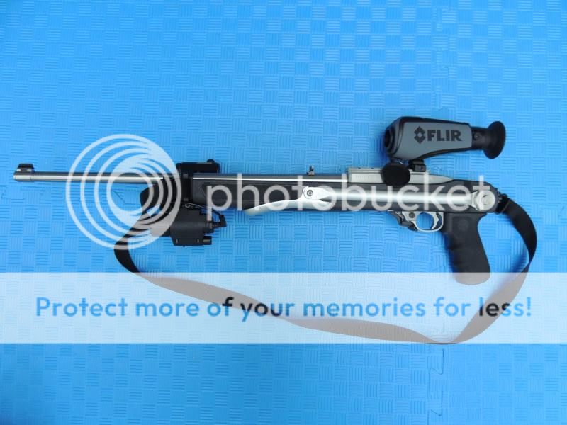

I tried the approach I saw online to mount my FLIR MS 224 thermal monocular onto one of my rifles.

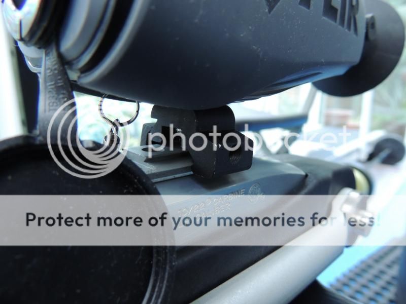

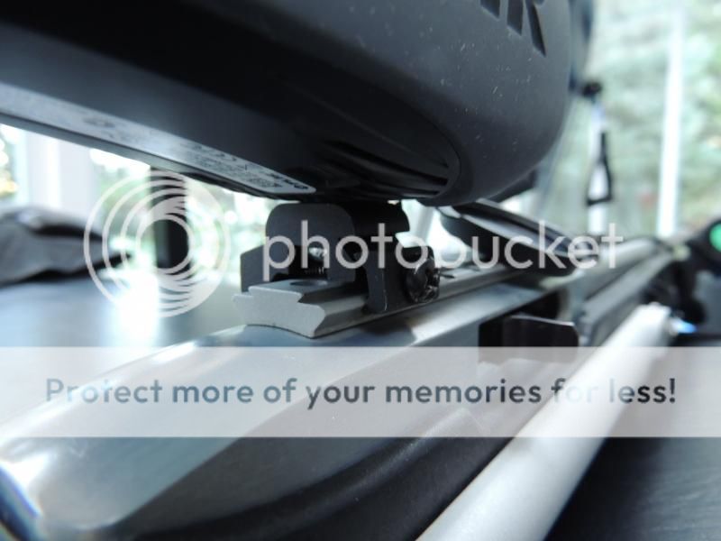

I took a cheap $25 picatiny sling mount. I used the cheap no name brand as it comes apart and didn't need to be drilled out.
I removed the swivel bolt and passed a 1/4" x 20 x 5/8" screw through it. I had to shorten the screw by 3mm and I ground off the top of the screwhead so that the mounts picatinny bolt could clear it.
There is no crosshair on the 224 so it is more of a detect the target and then light it up with the light/laser or aim with the red dot.
The hot white object at the bottom of the screen is the 10/22s front sight. At close range using it as an aiming point would have you printing higher than the sight on the screen.

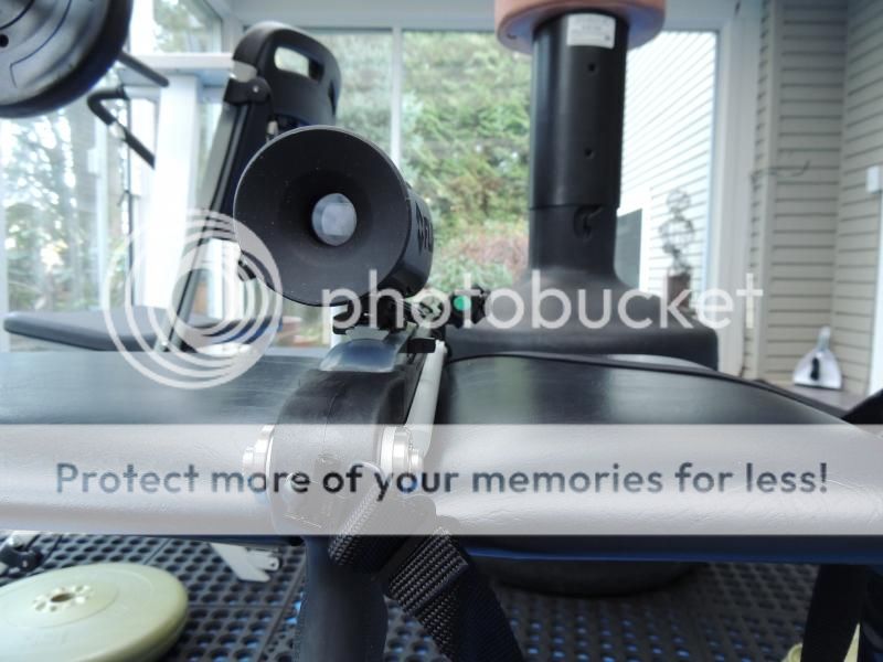

I had it on my .357 magnum Timberwolf pump and it seemed OK eye relief wise.
Recoil wise I doubt that the .22 rimfire would damage the camera but I wouldn't risk it with a .308 or larger.
Id add it to a carbine!
it has 2 modes, sleep and kill, and you're not in your jammies.

It looks silly but with a a 110 round GSG magazine it might be a hoot to shoot at night where it is legal to do so.
It's too bad that these low end cameras have such slow refresh rates as it would be fun to be able to track your rounds as you fire them or as they impact on the target.
I finally took it to the range. It was 14C.
By placing the lower 1/3 centreline on the target I was able to hit a 4" cube at 25 yards a couple of times but it was dicey.
I moved my target stand to 7 yards and was able to see the bullets impacting the paper on cardboard target through the FLIR camera set on white is hot. the bullet holes showed up because they were hotter than the surroundings.
All in all it's not a practical nocturnal target rifle setup unless the range is short or the temperature is kinda cold.
