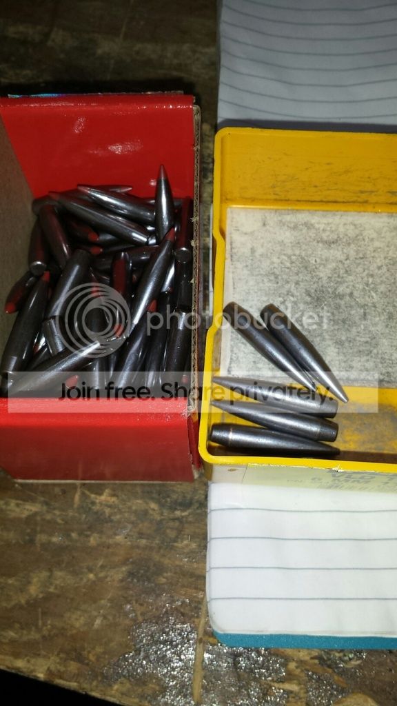

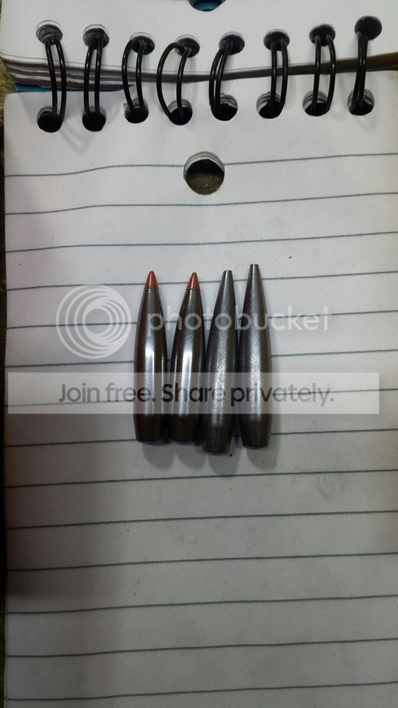

I always applied the moly dry until last night. I would tumble them for a few hours than shake the bullets out into a large tube sock and then tip it back and forth to polish off the excess moly, then dump the bullets back into their boxes.
The bullets I did in the water, the moly coating seems to be thinner and adhered to the bullet way better than it ever was when I did dry. It doesn't rub off on your hands when handling the bullets and is much harder to rub off if you rub the bullet on your jeans or something.
Just something I thought I would pass on for others to try. Here a couple quick pictures between the amax's I did last night and some 115 bergers that I have had sitting around that were done dry. The Bergers have been rolling around in that box for a while.
