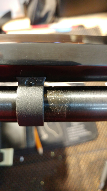

The reason I ask is that the Henry Big Boy in 44 mag that I recently purchased off the EE has an issue that I think warrants warranty service. The previous owner said he put a box of 44 special down the pipe.
I brought my new to me Henry to the range today with a box of factory 240 gr rounds and some home rolled rounds for load development. After loading up the magazine tube with 10 factory rounds, I put them down range with no issues. When I went to reload, I noticed that the brass plunger was difficult to turn and even more difficult to remove. That is when I noticed that the magazine tube had moved forward about 7/16 of an inch. The roll pin that holds the magazine tube in place was still there and you can see the half moon shape in the magazine tube that the roll pin slides in to prevent the magazine tube from moving. Obviously it's not doing it's job.
