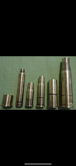

Well your die is already screwed so not much to lose in trying to fix it. I’d cut it back behind the break and chamfer the inside edge. Most of the sizing is about 1/2” from the rim and forward. So may work for you.
Best I could do at the moment is an angle grinder. Just did a file test and their glass hard might be part of the reason these dies had issues.
Angle grinder with a cut of wheel then switch back to a grinding wheel. If you had a square you could move it around the die and keep hitting the high spots. Could get you close. A ball stone in a drill would give a bevel on the inside. The steel in the die should only have the top layer hardened.
Stuff like this is why I bought a lathe. Expensive toy but when you need it it’s worth the money.
Probably the next big thing I’m buying it’s only gonna be the cheapie Chinese ones but better then trying to spin stuff in the old beaver wood lathe.
I filed on the part the broke out and even a chainsaw file won’t cut it.
