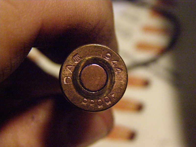

Found A 303 Proof Round In Some Odds And Ends At The Show Yesterday Pictures Are Up
No channel or groove around the primer it looks like its reinforced in that area. The area around the primer and the primer are flush no area for the primer to expand like normal rounds.

I've seen .303 Proof rounds marked with "Q" headstamps, base stripes, case stripes, bullet rings, copper-washed cases, and some early MkI and MkII rounds with "PROOF" in the headstamp, but never the Canadian variation originally posted. If I had one to put on my table at a cartridge show, I would start out at USD75.00, or even a bit higher.
I'm not a serious .303 collector, so they may be out there, but I've never seen one like that.
The DAC 44 is listed in MacDonalds book on the 303, it is a known round. I remember picking up some WW2 proof rounds in Truro years ago, likely the same, but long since gone, so I dont remember for sure. Value is what you can get obviously, I would say 10$, but thats at a typical Maritime gun show. At a dedicated cartridge show, who knows. The real value is to the 303 collector, otherwise I dont think the appeal is really that strong, but hey, YMMV.
Here are a few pictures of the round.
