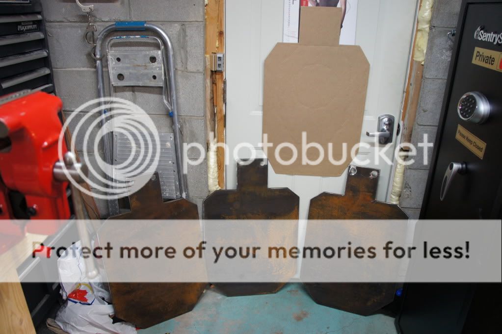

Picked up three ODPL style AR500 steel targets today. Just need to get them painted up and get some bolts and chain to hang them.
Them suckers are HEAVY!
They are 1/2" AR500 plate, and the seller had tested them with calibers up to .338 Lapua and .50 BMG with nothing more then superficial damage to the plates.
This works perfectly for me, as that is what I intend to launch down at them from long range, so I need somthing that would hold up. They are very close to the ODPL targets in size, within about 3/4" or so when you lay the target right overtop of the steel. Close enough for some informal long range plinking with .50 BMG. :D
I have looked around, and seen various prices online for similar styles of targets, ranging from $300 a target to $650 a target.
The total with this guy for ALL three targets came to under $500.
The seller is "MattMoser" on CGN, who is an all around great guy to deal with. I highly reccomend dealing with him.
I will post some pics of the heavy and light caliber hits on them after the shoot next weekend.
Cheers. :cool:

I've referenced this thread/post a few times about AR500 steel targets, and how tough it is to .338LM and .50BMG ammo. One of the reasons I purchased targets from Matt, the other being he is local to me!
Check out this thread, post #65, and you can see how minor the surface damage is after being hit by these rounds. The targets in this following thread were made by MattMoser, using the same material that the OP purchased.
