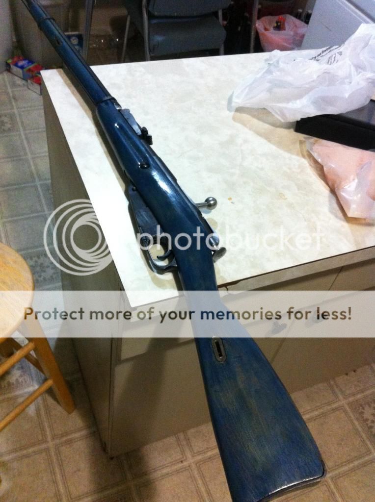

Hey Guys, I found a Mosin Nagant with a stripped stock at a pawn shop near my place for next to nothing.
I thought to myself, hell, why the heck not? Could be a fun project to refinish it one way or another. Already Bubba'ed so I can't mess it up.
How should I finish it? I will put up pics as soon as I get home of the stock and hand guard.
As promised, here are the pics
First off, how can I get the darker spots out in order to make whatever finish more even?

When it comes to refinishing old wood, you need to work with what you have. Often it won't end up looking like a brand new rifle. Just trying to set expectations. That said....
I'd try a heat gun to heat up those dark areas and see if it's oil. If it is, keep heating up an area and immediately wipe up the oil as it comes to the surface. You'll see that as you remove the heat the oil will soak back in. The more rapidly the oil soaks back in, the less oil there is in there. Do this until you can't stand doing it anymore. :)
You can steam out some dents with a water dampened rag and an iron. I showed the process in a thread I started in this forum a long time ago. You can search for posts I started in Red Rifles about refinishing my sks. After the steaming process, grab some fine sandpaper and smoothen the wood.
The finishing process from here is really up to you and what direction you'd like to go in. Some people bought garnet shellac to mimic what the arsenal did when storing them. Other people use an oil finish. Some leave the wood light and oils like boiled linseed oil are light, so you end up with a "blonde" looking rifle. Others want a darker colour and may tint the oil or stain the wood first, then oil on top. I tend to do this.
fyi, the darker you want the final wood, the more it will hide those dark areas you are trying to eliminate. If you want a "blonde" look and can't get rid of those dark stained areas, you may be disappointed. So this is where an open mind and working with the wood you have really helps out.

Proper finish for this rifle is clear or amber shellac. Throw on a coat of BLO, then a few coats of shellac and lightly sand each coat, polish the last if you want.
