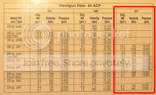

I just looked at this thread again and noticed that Ganderite is also willing to sell WW571. With the current powder shortage, I thought I'd mention that WW571 can also be used in 45 ACP loads. The following data is from the 15th Edition Winchester Reloader's Manual, 1997. I used up quite a bit of 571, under 230gr lead round nose bullets in my Colt Gold Cup.
Thank you.
HS7 (same powder) is about the same speed as Blue Dot, but meters much better. Good powder for heavy pistol loads, heavy shot shell loads and heavy cast bullets in rifles.
It is no longer made and list if for anyone who used to use it as a favourite and wishes they had some more.
