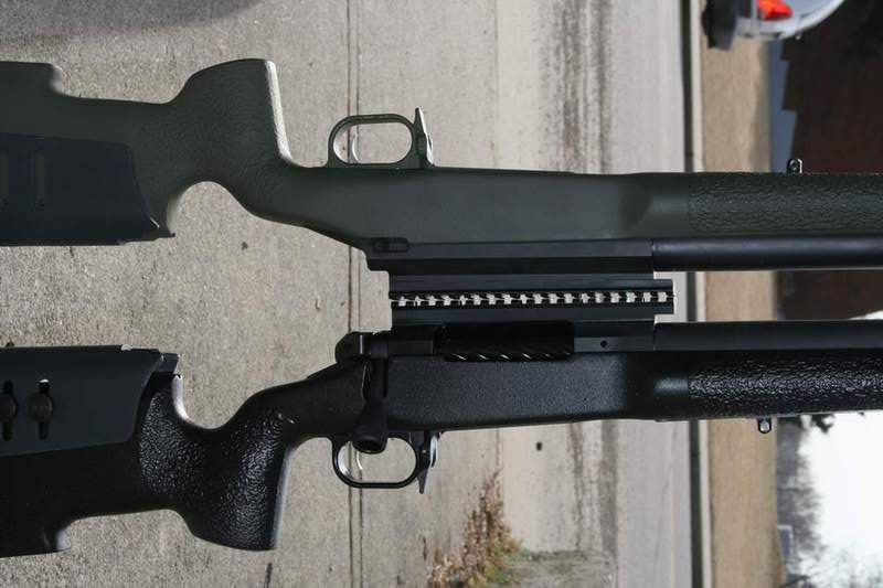

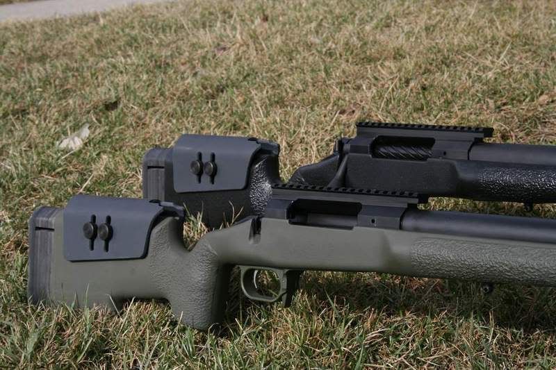

I took a look at your pics and then, since I was in the nieghborhood stopped by where your guns are being carefully stored. At first glance it looks like the scopes are up higher then normal, but after getting behind one with the adjustable cheek rest, while laying prone, it felt very natural. Just to satisfy my curiosity I grabbed a set of TPS medium rings off the shelf and matched up the center line of the rings on the US Optics scope and the TPS and they were the same hieght. The TPS mediums happen to be the same as I have on my gun. What I found different though with the help of "the un-nameable one" is that the PGW action has a 1/8" or close to flat top on the action and then the 20MOA base gets bolted onto it from there. Right off the bat you've gained about 1/8" before even setting a scope on it. Then you've chosen to go with a 35mm tube which adds another 2.5mm to the hieght of the scope off the barrel so you're looking at roughly 1/4" more then first putting a 30mm tube scope on your gun followed by the extra metal on top of the action. You're going to be able to gain back a max of probably 1/8" just because of the limits of material on the rims themselves, but with an adjustable stock like the one you've chosen, which is top notch by the way, you've got all that covered. This is classic cattle mentality. I hope everyone that has commented negatively has learnt something by what I've pointed out here. Your scope doesn't have to lay on the barrel because of your stock choice. It's not like you're trying to mount this scope on top of a carry handle on your AR or anything but I guess you guys have waited this long.

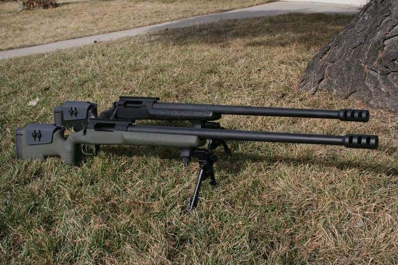

Just waiting for some Low rings. We decided to take the scopes down a notch. Here are some photos of both mine and my buddy's rifles together. Mine is the black one:
