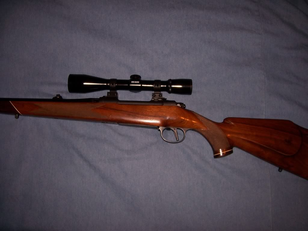

I bought a ZKK600 (30/06) in 1974 and really liked it. It shot quite well "out of the box" but , like any "bedded in the wood" rifle was inconsistent shooting very well one day and not so well the next. I decided to glassbed.
First time around I bedded it full length. I figured since BRNO went through all the effort to incorporate the forend screw, I would continue to use it. The rifle shot better but with one major flaw. If I shot a 5 shot group, it would be a decent, round group. If I then allowed the rifle to cool only the length of time it took to walk up and check the 100 yd target and walk back, the first shot of the next group would hit about four or five inches high, the next shot a couple inches lower and the third shot back at the original point of impact. From there, if I continued to fire, all subsequent shots would group in that area. If I allowed the rifle to cool completely, the group would form where it should have as well. Every other bolt action rifle I had worked with, I had floated the barrel so I decided to do the same with my BRNO. I did this by simply removing the necessary material from the forend and removing the little block into which the forend screw was threaded. I then glued the screw back into the stock just to fill the hole. It worked perfectly and the "walking point of impact" problem was gone.
At the same time, I noticed the barrel had a noticable tight spot right at the location of the rear sight boss. Although accuracy was pretty good at around 1 inch or so at 100yd, I couldn't stand the thought of that tight spot so I cast a lead lap and lapped the barrel with some 400 grit clover compount to eliminate the tight spot. It took some time, by the way, but I got it done. I cast a second lap and polished the bore with JB compound to finish it.
After this the rifle was very consistent and was, in fact one of the best shooting factory rifles I have ever had. I shot many 5 shot groups which were well under 3/4 inch and even some under 1/2 using 180 Sierras.
