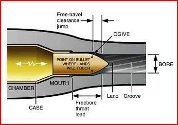

Just started reloading for my Weatherby 300 Mag. According to Wby, the throat depth or freebore of the rifle is .361. So if I look up the COAL of the bullet I am reloading and it is different than .361, how do I componsate?

There are ways to measure the max COL for your particular rifle, then shorten this dimension to get a suitable bullet jump. Barnes TSX and TTSX supposedly like a jump of about .3 to .7.

With any rifle, seat the bullet long, chamber, look for rifling marks, seat bullet deeper, etc until you have load that just touches the rifling or is 20 thou off the rifling.
Then see if this OAL will fit the mag.

The early Weatherby rifles had chambers cut with purposely long "freebore."
Ganderite explains very clearly what it really is. Weatherby did this because the powders available at the time Roy Weatherby was trying to market his creations were to fast. He had to find some way to be able to stuff lots of powder into those huge cases but still keep pressures down. He did this by cutting "freebore" before the leade. This meant the bullet had to jump quite a distance before engaging the leade and pressure was slightly reduced and maybe even bled off as escaping gasses went past the bullet before a positive seal was made. Not much but enough. One of the early Weatherby rifles I used to own had 1.350 inches of freebore. It was a 300 WbyMag as well. It never was accurate and quite honestly, recoil was intense. Because of magazine limitations and bullet lengths it was impossible to seat the bullets close to the leade.
Later model rifles chambered for Weatherby cartridges either decrease or eliminate freebore to more advantageous depths. They also have tighter throat dimensions.
You don't mention the rifle you are loading for so follow Ganderites method to establish where the bullet ogive will contact the leade and if you wish, set it back a few thousandths at a time until you find the sweet spot.
Many of the new rifles have throat diameters that are so close that seating a bullet deep or close to the leade, or even on the leade has little effect on potential accuracy.
If you happen to have a rifle with a "sloppy" throat, seating the bullet so it is very close to or touching the leade is often a very good way to wring as much accuracy as your rifle is capable of with any given bullet.
