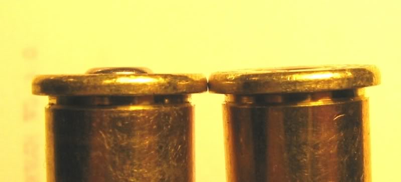

My primers have not backed out from pockets. However the flow of primer cup does stick out from rim edge with fp indentation after firing. I feel that 32-20 is not the right case for French or sweed.
I have had no issues with my 1892 with Remington .32-20 converted brass, maybe they have a thinner rim or my 1892 has a little bit more clearance than your one.
gents; I had similar issues with my October 1895 manufactured military issue Swiss 1882. I found that Winchester, and to a lesser degree Remington, 32-20 rims are slightly too thick and binding sometimes occurs. Starline brass on the other hand has a slightly thinner rim and work very well for me. My typical loads are throwing 100 grain waxed lead wadcutters around 950-1000 fps, so fairly "hot". I also have loads that range from 675 fps mouse farts to 1200 fps (with 72 grain 32 ACP FMJs), and still no issues. Use Starline if you can find some. I have also thinned the rims of Winchester brass and it also works well. BTW, I use both trimmed (23mm) and untrimmed (~33mm) brass, and no issues.
Well that's what I was wondering. My 1892 is 1914 thus restricted and has almost no wear. So with time and use may be headspace does get larger? By the looks of it I may have to just load cut Russian brass for 1892 and 1887.

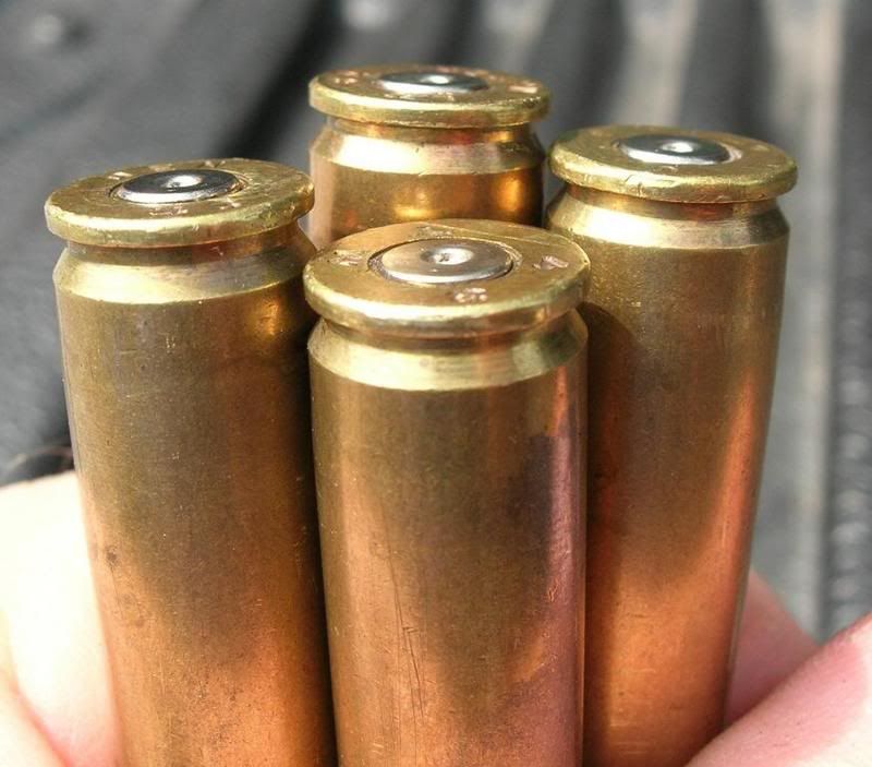

Here's how 7.62 nagant brass look like in my 1892 in comparison with 8mm fiocchi cases.
Once I find a way to shoot my factory PPU Nagant ammo, I will trim and full length size the once-fired brass... the Nagant rims are ideal for the Swiss revolver (and Swedish and French), but Starline is ok for the Swiss.

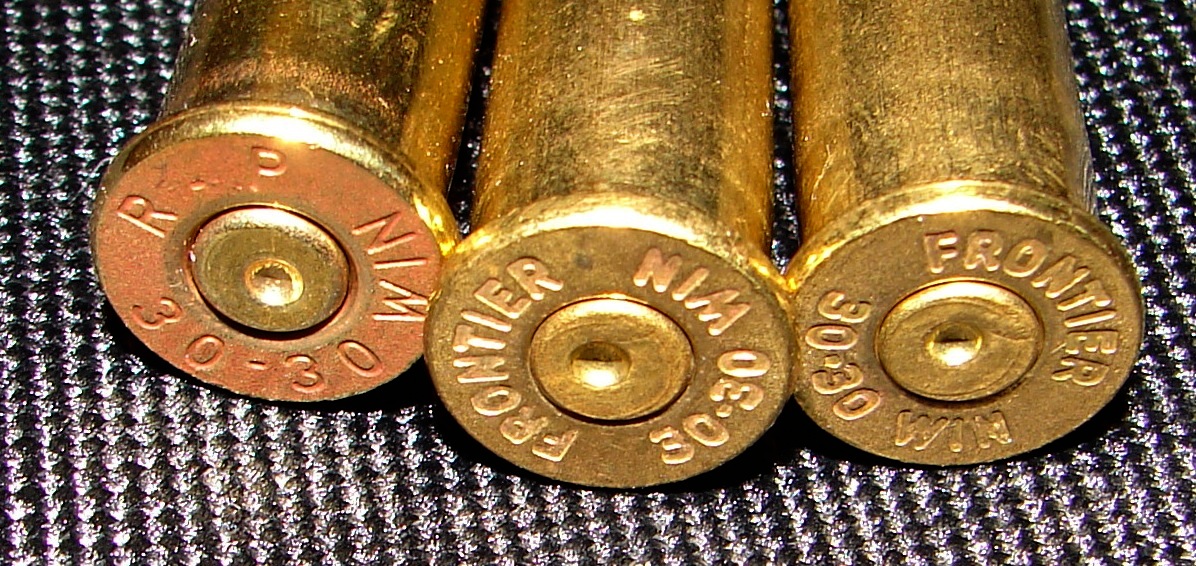

Sorry, but sure they do, it is reasonably common in rifles and handguns like revolvers.

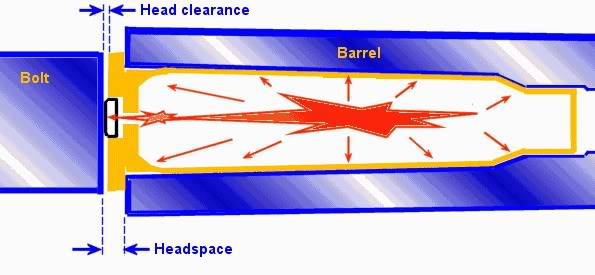

It is usually caused by excessive head-space between the rear of the cylinder and the breech face and lighter loads and dry grippy chambers where the force of the expanding gas in the case is only enough to force the case walls against the chamber walls and not enough to force the back of the case back against the breech face unlike with higher pressure loads which will usually stretch the case length and re-seats the primer back into the primer pockets or flatten them.
Excessive pressure loads will give the mentioned raised part around the pin indentation/deformation from the excessive gas pressure pushing the primer cup to start being forced to start flowing back into the firing pin hole. If that load goes much higher or if the firing pin is too pointy the excessive gas pressure can cause a primer rupture.
If you are getting raised primer firing pin indentation deformation your loads are either way too high for a antique gun or your primers are made from very soft metal and you may have too big a firing pin hole.
I have seen some ammo and guns do it a number of times over the years. Here are some examples I grabbed off the internet -
Well Thank you for pictorial explanation. I have some bulging in primer cups, but not as bad as in 30-30 shown.
Anyways, I feel that 32-20 brass from RP and WIN has rims too thick for my revolver.
