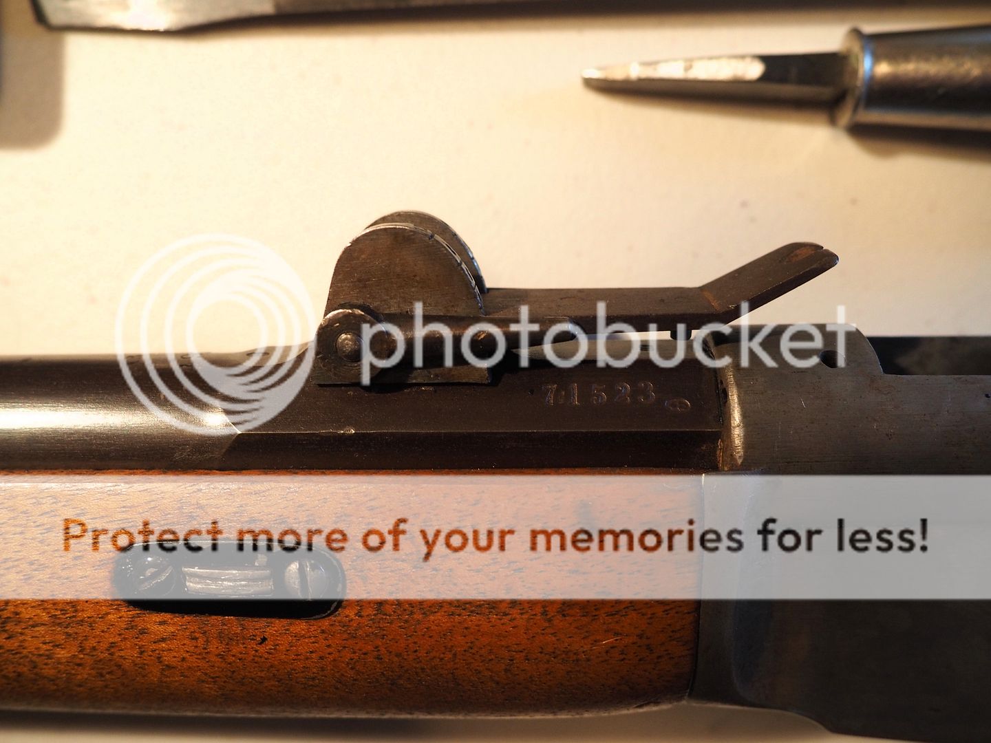

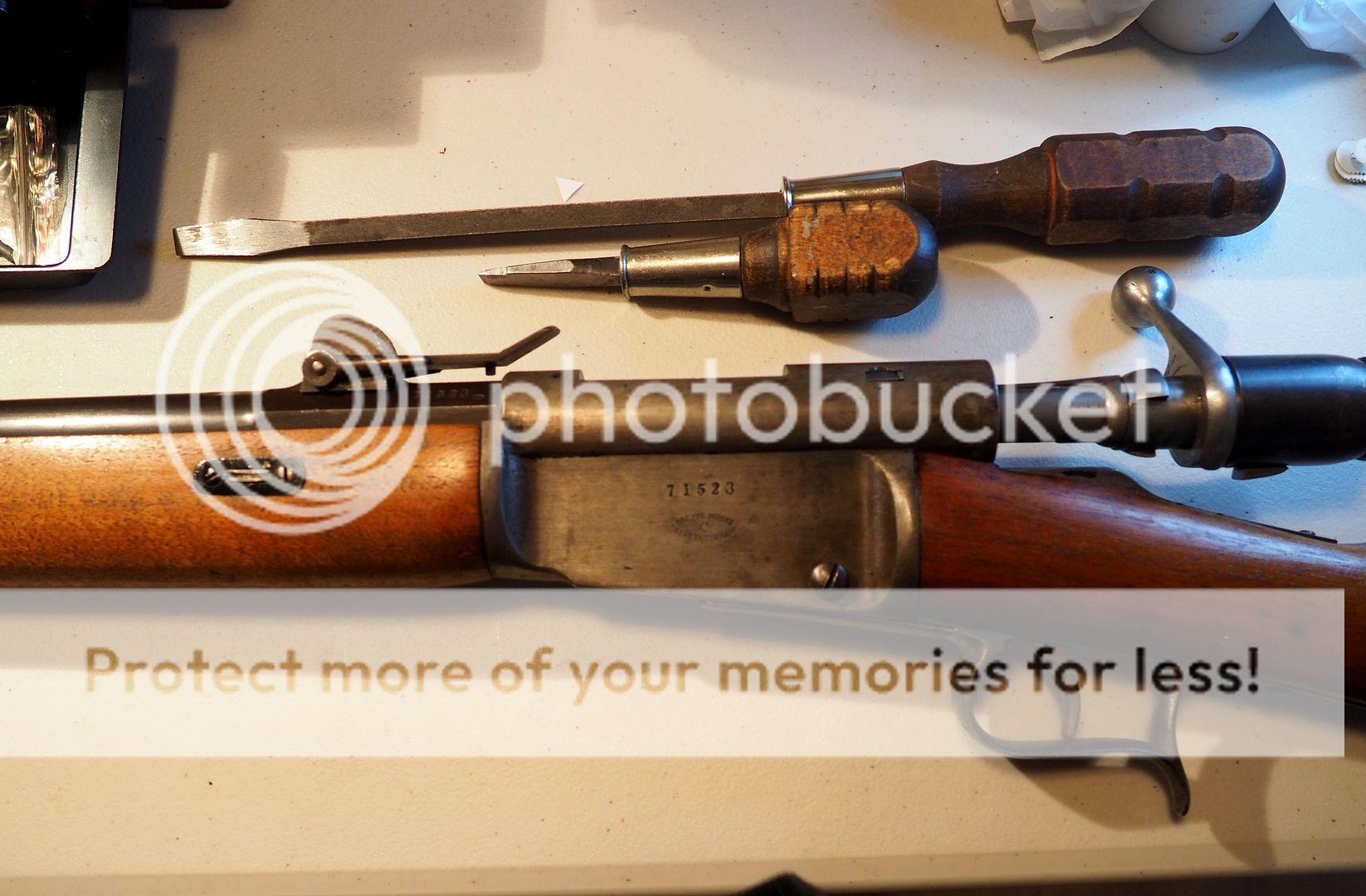

It was missing many parts, cartridge elevator assembly parts, rear sight leaf. butt plate, barrel band screws, and cleaning rod.
I found one recently from Tradeex that would't fire and bought it for a parts gun since it had most of what I needed minus the barrel bands and screws. Some bubba sporterized the parts guns. It wouldn't fire due to broken rimfire firing pin that also jammed the cartridge elevator in the up position. Seems previous owners did not know what oil and grease is for.
Finally put it together last night and it works fine.
Anyone know a Canadian source for the barrel band screws and cleaning rod?

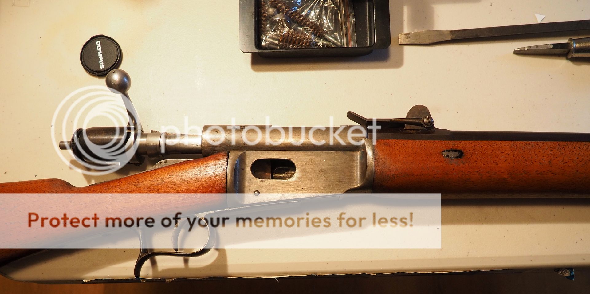

Got it with the Black spray Goth makeup on the metal parts it had. Added missing parts from a parts donor Vetterli.
After stripping the black paint.
Makes a distintive deep Ca-chung sounds when the cartridge elevator loads a round.
Bolt action with a lever gun feed mechanism.
