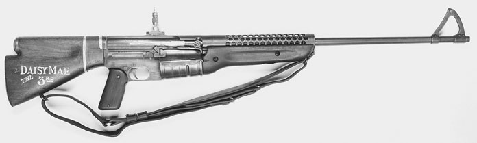

IMHO, that would depend on the condition of the Johnson when the smith did the work.

The rifle in the pic could easily have come out of those parts bins.
Whoever did the work, it's very good.
The maker might have seen one of the later iterations of the Johnson rifle that was shown to the Netherlands Purchasing Commission representatives that visited Long Branch. They were getting ready for the colonial reconquest of Indonesia around that time. I am not sure if that model of Johnson rifle was ever produced in quantity.
'Daisy Mae'

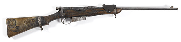

I remember seeing that a few years ago. The Lee Enfield TAC A1 Mk.III. Goofy but looks well executed and probably accurate, though not suitable for milsurp competitions. #Quiet

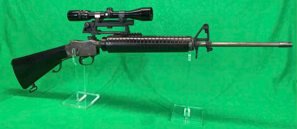

I've seen worse and that actually looks quite functional. The receiver/barrel could very easily be cleaned up and make a fine base for a decent hunting rifle.
