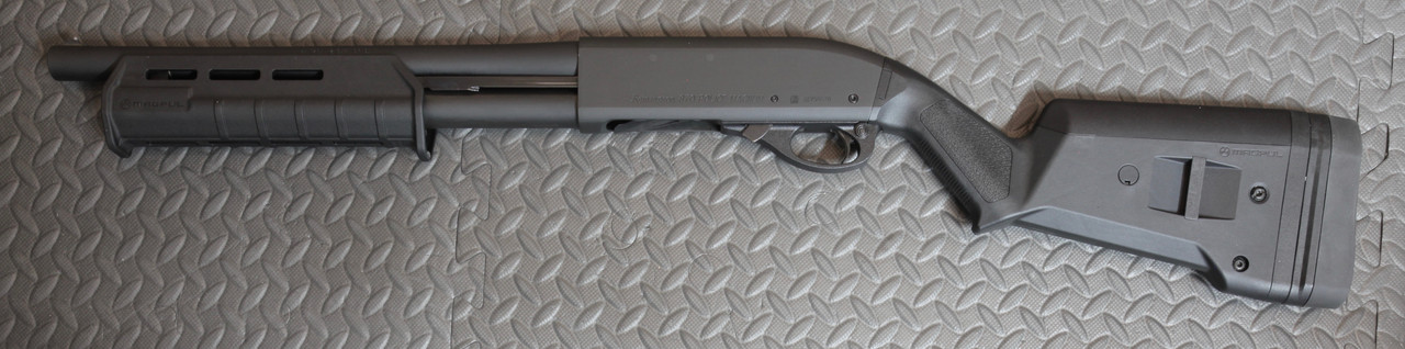

Your 870P comes with a magazine cap that has a sling swivel stud similar to this:
Although the Magpul forend does stick a little further forward than the stud so I'm not sure if you will like that. I highly recommend upgrading to the S&J +1 extension with sling plate, as others have suggested:
Your shotgun:
I have a very similar shotgun to yours. On mine I recently installed a QD socket for a single point sling in the Magpul stock, that can convert to a 2 point sling with the S&J front plate and a paraclip.
Single Point:
2 Point:
I'm not sure if I like the 2 point sling arrangement - time will tell.
