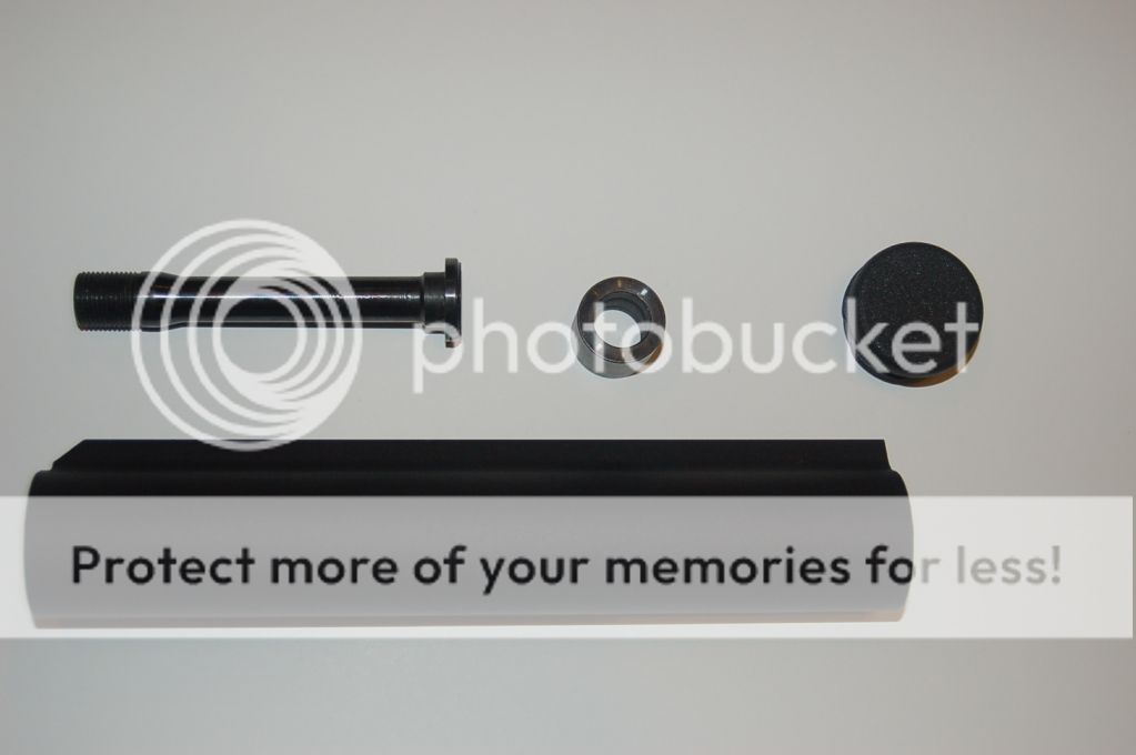

Please try this
This is six position fixed stock tube. It attaches to the rifle with original fixed stock screw with spacer (All included). Includes polymer tube plug. Machined of high strength aluminum. Hard anodized finish. This stock tube is compatible with commercial-spec stocks. It attaches at the same angle as original factory stock.
Length 175mm, weight 175g. Fully extended average M 4 butt stock with this tube is 285mm long.
Made in Czech Republic
Available at corwin-arms.com

Please try this
Martin,
Will that tube work with the sling adapter plate, or will it make the attaching point off and loose?
