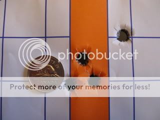

After getting my new scope sighted in here's my three shot group. I'm satisfied with that from my hunting rifle as I'm not a "sniper" by any means!!
