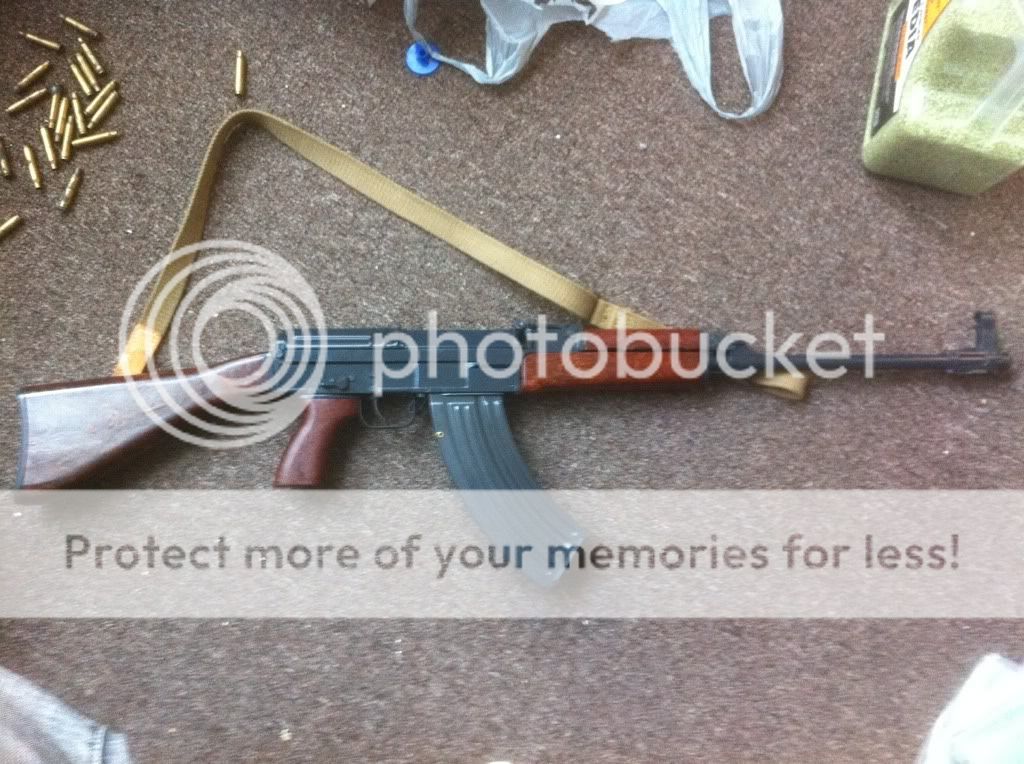

Pictures of somethin else?

Well I just came from picking up my new CZ-858. After closer inspection, this almost seems like a completely different model of rifle then the one before. The receiver is thinner, trigger guard is different, the internals look slightly modernized and sleeker. All in all a pretty rifle! But most importantly, the pins do not come out as I squeeze the trigger!!! :D

You are correct. This is a gremlin 2.0, that from what I understood hadn't been seen at Williams Arms nor Wolverine(I may be mistaken on this part). It was suspected to be out of spec pins, but when replacement pins were sent, they too did not work. After looking at the the outside of the receiver on my new rifle, it appears to have been milled down to make it thinner and the pins fit. I believe my 1st rifle was an early Gen. model that was sent over early and out of spec.
