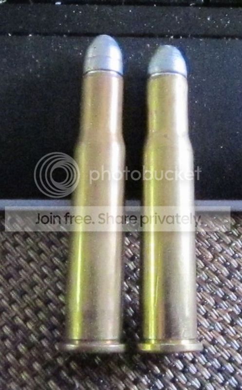

Further to my load of 5 gr. of 700X and a 93 gr. Lee ww: Somebody above posted that they used fireformed cases - good idea! I've found that no resizing is required when firing these little loads. I have been able to get away with re-priming, load powder, shove another bullet in and very lightly crimp the case mouth. I may or may not bell the mouth a weeny bit with a FMJ round, usually an 8x57. I try to use ratty old cases. Here's a blurry pic of a 120 gr. Lee (left) and a 93 gr. Lee. I don't recall if I sized these bullets or not. Likely did.
