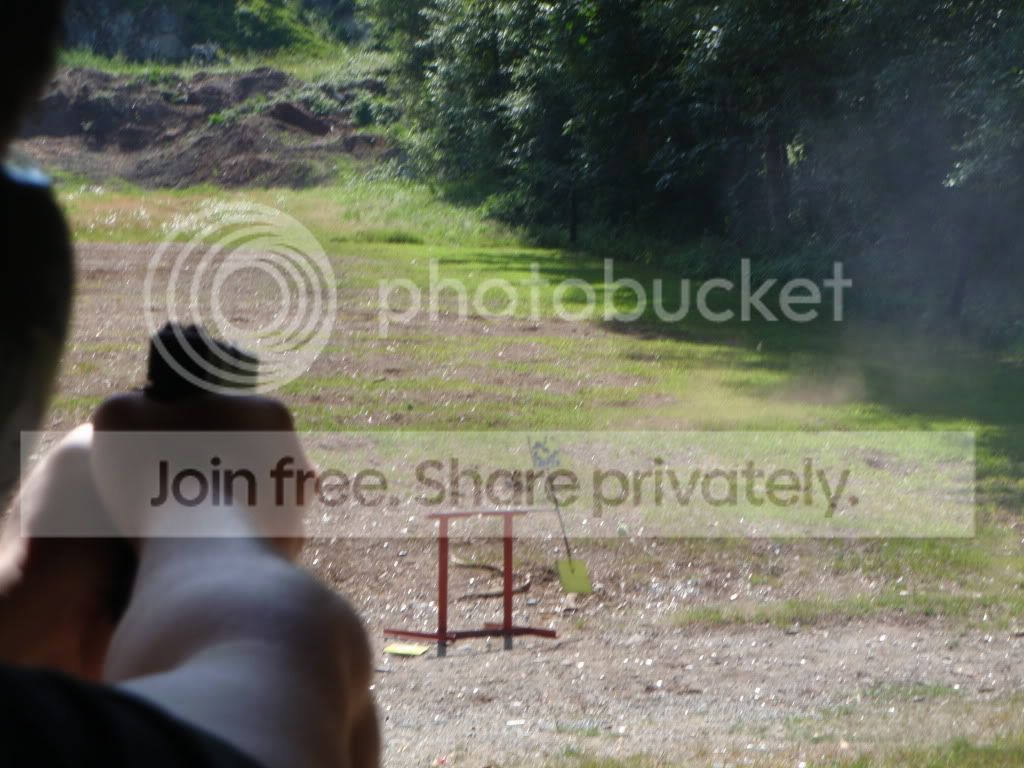

I finally made up a paddle wheel target in my shop today. The target itself is made from AR plate. I'll get it a whirl with 9mm, 45acp and .308 this weekend. It took only about an hour to make(prep work included) for the first one. I could cut the time down by half if i made more. I'd price these at about 100.00.

The G17(9mm) barely would move it. The g21(45acp) would spin it nice. .308 depending on the load would set it spinning for a minute. .308 moly coated 168 grain would penetrate through the AR plate at 100m but not 200m.
It was a great target to shoot at and we're fabing up two more.
