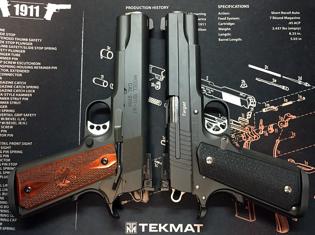

I've been sitting on the fence for some time on buying a new magwell for my Springfield 1911. Originally, I was going to order an Ed Brown from Brownells but after shipping and exchange rate, I figured it wasn't worth it. Wanstalls started carrying quite a selection of Fusion parts and with only $10 shipping, I figured I'd give them a try. Oh, I also ordered a K-hole trigger for my SigSauer Target 1911.

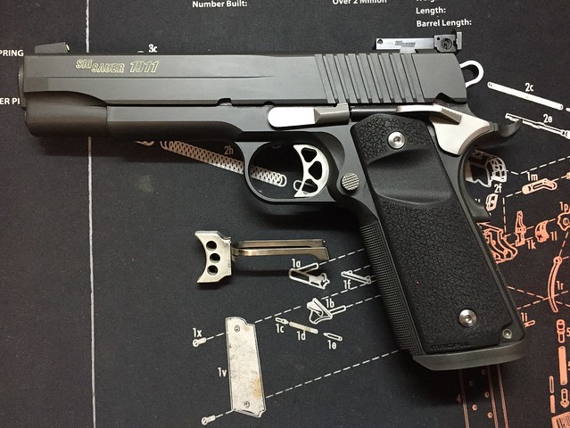

The Fusion trigger came packed loosely in a clamshell package along with the overtravel screw and allen wrench. As a result, the trigger's finish was a little marred up which was a little disappointing.

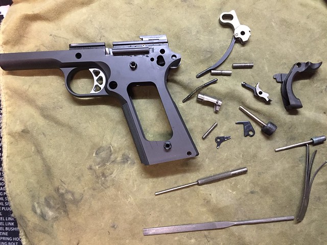

Out of the box, the trigger could slide in all the way with just a little bit of rubbing on the frame and only required a light bit of fitting to get it perfect. The trigger bow had sharp edges and needed to be dehorned.

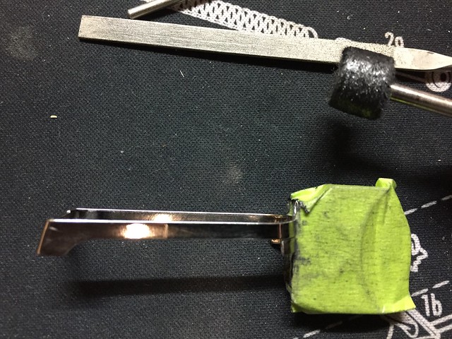

After adjusting and fine tuning the trigger bow, I polished it to a mirror finish. The overtravel screw, once installed in the trigger, was pretty loose, as in you can wiggle it around. It was too loose for my liking so I carefully crimped it using my bench vise. I made sure to use Loctite on it to prevent it from walking.
A quick touch-up on the trigger shoe with a steel brush mounted in a Dremel make it looking somewhat new again.

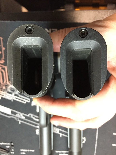

I've seen some pics on the internet where there was hardly and metal on the magwell to allow for blending. That wasn't the case for me. It looked almost identical to other magwells I currently own.
Dlask brand magwell on the left, Fusion magwell on the right. They're pretty much identical.
