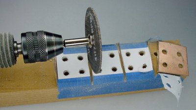

I would have used this and a lot of swearing :).
