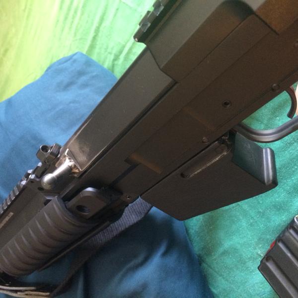

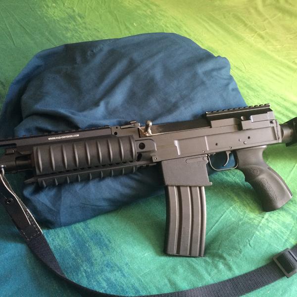

A little eye candy:

A little eye candy:
