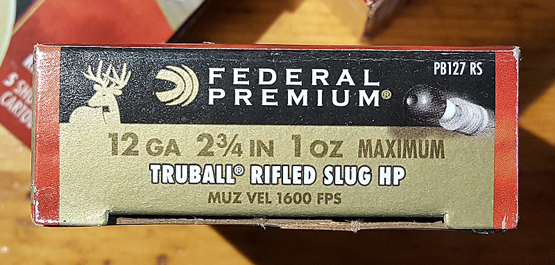

I have tested a lot of slugs ....
The best accuracy I get out of smoothbore guns is with Federal Truball slugs. If you have the appropriate sighting system .... with those Federal Truballs a smoothbore becomes a 100 meter gun for hunting large game.
I tried several Brenneke slugs but they are not as accurate.
I also had two rifled slug guns ..... but I sold those for several reasons. Rifled barrels are finnicky .... and one has to try to find the sabot/ammo that that particular barrel likes. I spent a couple of hundred dollars in ammo and to try to find a sabot load that would work out of those two guns, and in the end accuracy was not much better than my smoothbores with the Federal Truball slugs.
And sabot slugs are really expensive.
In short ... and from my experience ... a smoothbore with Federal Truballs and the right sighting system is a 100 meter gun.
And a rifled shotgun is a 150 meter gun .... max 175 meters.

If you are shooting at deer within shotgun range, do you really need to have a scope? Try some 2 3/4" Federal Truball slugs, you might be amazed at how accurate they are. Trust me, I would never try to talk anybody out of buying a new gun. Buying 6-7 different brands of ammo to find what works best is cheaper than a new gun or a new barrel.
