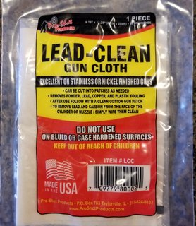

I use lead remover cloth, the Birchwood casey brand. It works OK, that is about 5 time as good as a bronze brush or brass wool. Steel wool also works OK. I ruined a bore with wipeouts"leadout" it is advertised to dissolve lead which it might do a bit but don't try any improvement on their system or you will dissolve your bore before the lead.

The lead cleaning cloth also turns black all the time and i found on lead it works better than jb bore paste
I know about the cloth turning black, even in a clean barrel. That was earlier in this thread. Unfortunately the cloth cannot be used on a blued gun, stainless steel or nickel only. Hence the move to J-B. According to one post, the J-B paste will also turn dark/black even in a clean gun. I'll have to conduct a little experiment when I have the time.
