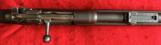

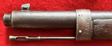

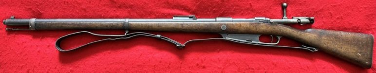

Here is my two Gewehr 88s. One is a 88/05 made in 1891 by Loewe that went to Turkey and the other is a export 1888 made by Steyr in 1894 and went to Ecuador. I got the export model when a batch came in about 8 or so years ago, they were all in pretty rough shape. If I remember correctly that was when a bunch of 1888 Mannlichers also came in, likely from the same source. The export model is interesting in that it has none of the later updates made by the Germans (original cocking piece, non-'S' modified, etc.) and it has a modified sling swivel. The sling swivel is often mistaken for a Austro-Hungarian M13, however the Equadorians used a different size of sling (not nearly as wide) and as such have smaller loops attached on.

88/05 on top with Turkish converted bayonet, 88 on bottom

Early cocking piece without the gas redirecting flange and the later much more common cocking piece with the gas redirecting flange. The Gewehr 88 wasn't the only rifle to do this modification, The Lebel rifle also had a similar modification done to the bolt.

Regimental marking on the 88/05 rifle

I had a look at this unit marking, I believe it is from the 27th (2nd Magdeburg) Infantry "Prince Louis Ferdinand of Prussia, reserve regiment, 16th company, weapon number (Hard to read). This regiment was based in Halberstadt and attached to the IV Army Corps.
I believe this particular unit marking is related to the 63rd (4th Upper Silesian) Infantry, 1st company, weapon number 170. They were based in Oppeln and Lublinitz and were attached to the VI Army Corps.
