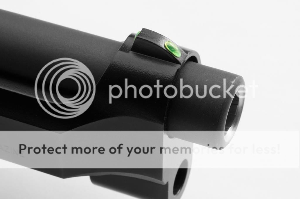

I went through a bunch of pages. Didn't see anything definitive on sights. Anyone added a fiber optic front or adjustable/target rear
Front sight is integral to the slide, would need to be milled off and a dovetail cut. Rear sight will take Beretta sights with some work...
